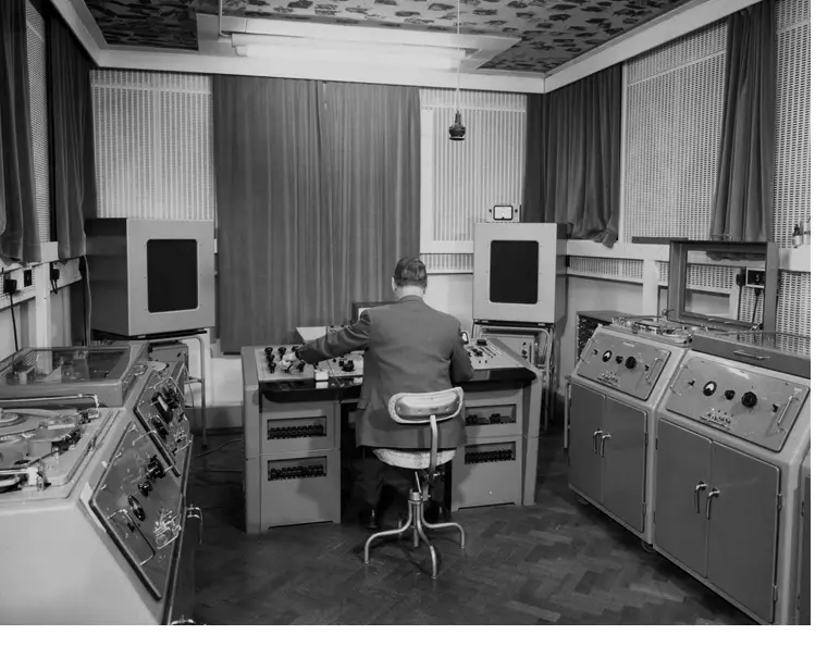

Look at pictures from old studios. Studio's that produced the first stereo, which we all admire. And the engineers who invented some of the tricks we use today. There are no equilateral triangles in most cases.
I'm not saying it is The Homy Grail. But it will provide a crosspoint, enabling recordists to supply a more universal track to the sound engineer who's mixing. And it already provides a way into new formats, for gaming and VR.

EMI is good enough for me..

Besides, I also seem to think there's no equilateral triangle in that EMI pic. Have a good look! Of course, it's a bit hard to tell from a pic that's only 2D...
Think again. All the guy has to do is roll his chair back about 3 feet, and there it is. Really no different than how I work - I've got to roll my chair back about 1-1/2 feet for the best stereo imaging.
