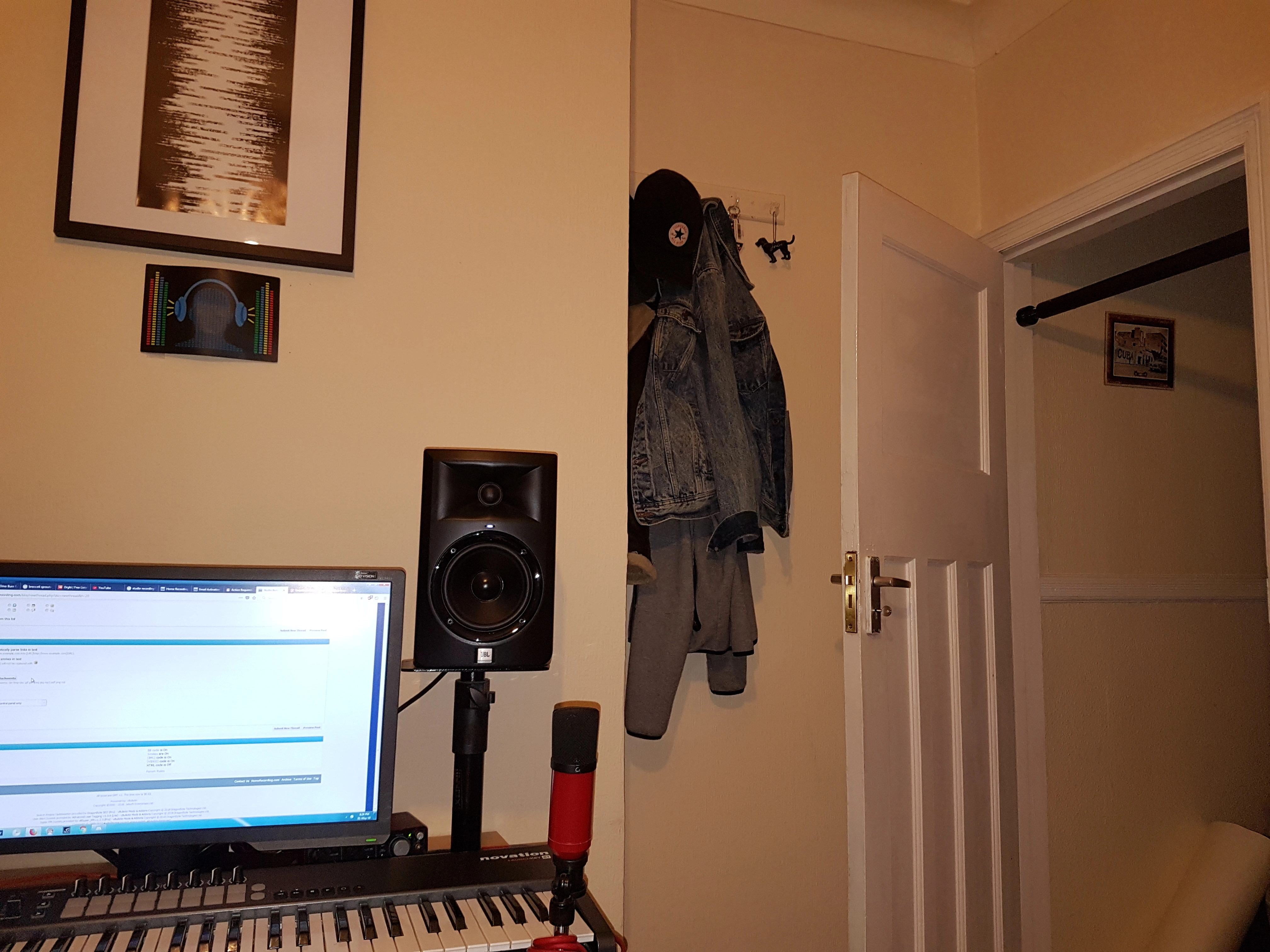

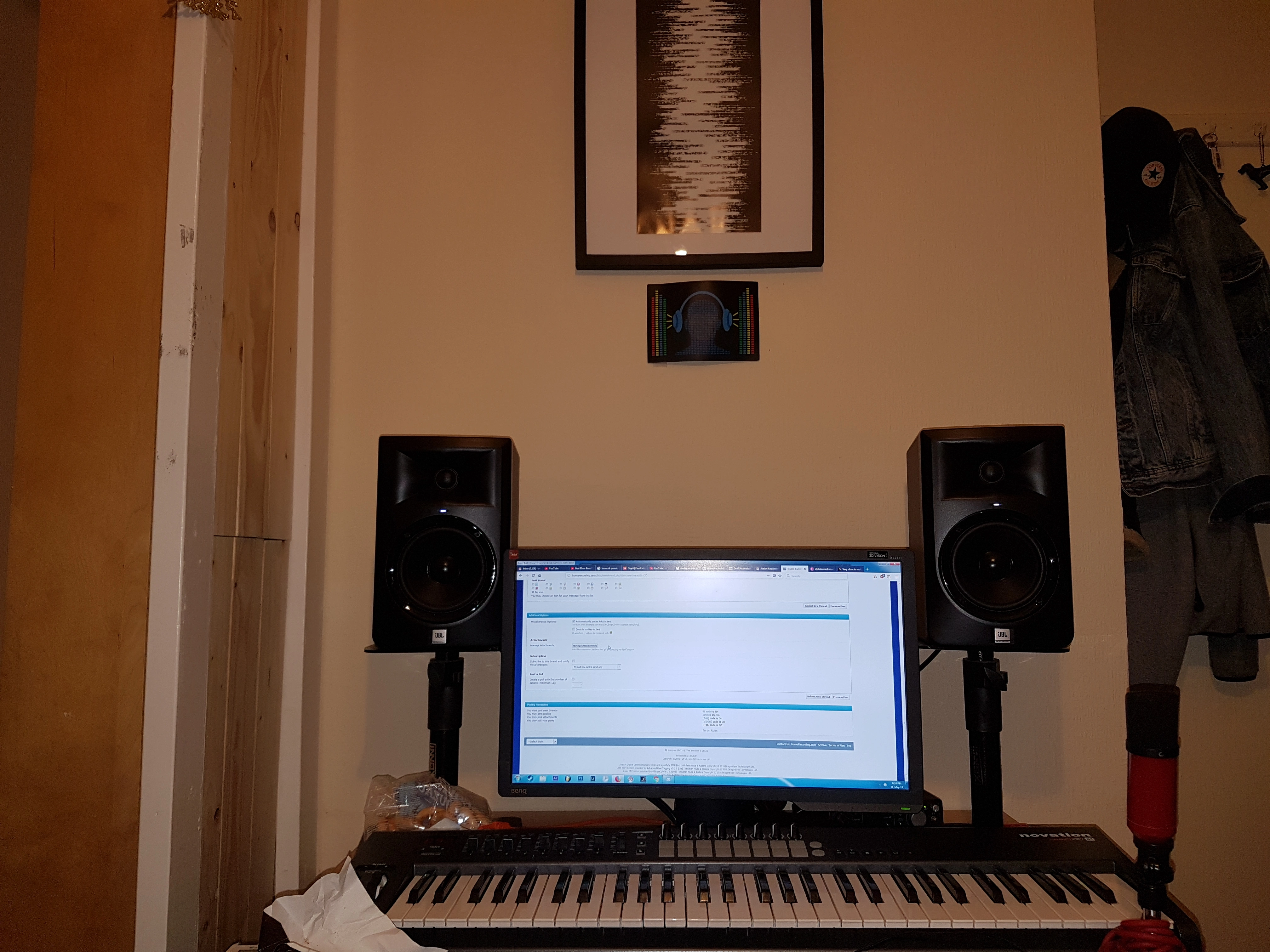

Hi! I started building a vocal booth in my home studio. Hopefully the photos are clear of the position of the booth. It's on the left side of my desk, really close to my left speaker. On the right side of the desk there is a big open space. Will that cause any problems for my mixes, as in, will it cause any extremely obvious reflections? What could I do to reduce any problems caused by that? It is kind of difficult for me to change the position of the desk in the room. Any suggestion or tip would be highly appreciated! Cheers! U4Yqo8.webpFpYS7G.webp
With your left speaker effectively sitting in a corner as a result of the vocal booth, you are likely to get an increased bass response from it.
I've never been convinced of the value of home-made vocal booths, and generally feel you don't get much better vocal recordings than you get simply recording in a room.
However, if you are committed to it, keep it and just bear in mind that it will have an effect on the response of the speakers.
As for reducing problems caused by it, unless you have already given acoustic treatment to the room to deal with any inherent problems it may have, I wouldn't worry about them.

Bass (in a room) is pretty non-directional so you probably won't notice where any extra LF support is coming from. What WILL happen due to that wall is that your stereo imaging will be buggered, especially since the wall is of 'finite' dimension, about 1mtr? That will put a 'step' in the response around the lower mids . Again you may not notice unless you have something to compare it with or can rig the speakers temporarily in another, more symmetrical space.
You could try a goodly layer of pyramid foam, 3"+ in the corner but few of us have anything like perfect rooms!

With all that sheetrock and no sound absorption, you've probably got a mess of sound already in that room. And unless you listen with you head almost on top of that keyboard, your speakers are too close together - you head and speakers should form an equilateral triangle.
That equilateral triangle is very much an internet invention. It all depends on your speakers and your room.
Some speakers come in a left/right config. Others are a bit more "omni". Some want to be closer together, others need a bit more space between them. Moving them just 10 cm can make a big difference, depending on the room.

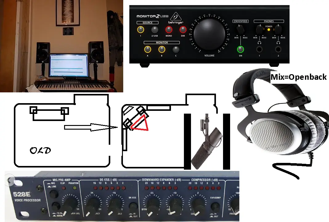

I will use sound absorption panels. My question was more if sound absorption on that side of the vocal booth will be enough, or if I have to move desk in a whole different place. The speakers are currently close to eachother because I am changing to a bigger desk in a few days and I just placed them on those small stands in the meantime.

Can you tilt your workstation desk so it sits in the corner where the booth is, rather than next to it? I think CoolCat was eluding to this in their post. I'm suggesting just adjusting the placement of the desk where it current resides next to the booth.
You'll lose a foot or two of space behind you/in the center of the room, but it will make each side (more) similar in reflective properties.
