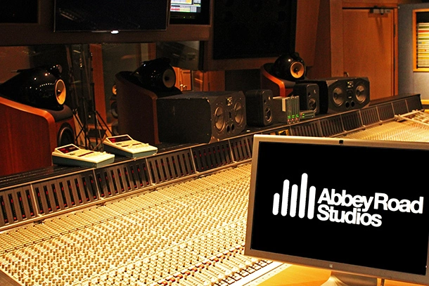

Just like there are no "studio monitors". The clearest example is the Yamaha NS10 you can find as a reference in a lot of studio's. It's a failed hifi speakers that was on sale because Yamaha wanted to get rid of it. One famous producer picked up a couple of pairs cause it was dirt-cheap. People tend to copy behaviour, so now a pair of these Yamaha's fetches a ridiculous price. And Yamaha has re-released these speakers in at least five different models, including even a 5.1 version.
And I was referring to real pro studio's. Never seen one with speakers in a triangle. Just look at the pics. Here's one example:
Just a note. Look at the size of that board. The monitors in the positions they are in are for certain points during the recording/mixing. Likely you would not hang out in the center of that huge board for editing now would you?
And the video monitor with the logo is obviously not where it is placed...haha! Position in a room like that is not relative to the center of the room because the room is large and well treated. Hell, even if the room wasn't acoustically treated it is better than most folk in a 8 x 10' room mode nightmare situation.

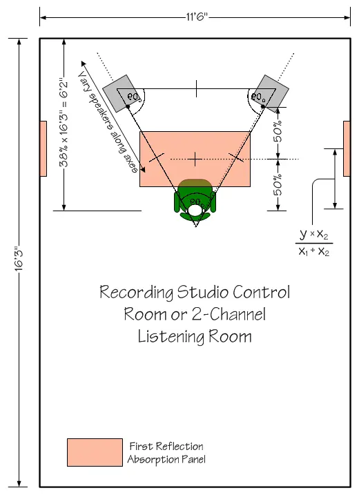

This shows a typical studio set up recommendation. This is from Ethan Winder, who is an acoustic design specialist:
http://realtraps.com/art_room-setup1.gif
Looks pretty equi-bloody-lateral to me! The BBC do have a certain reputation for audio excellence and technical knowledge?

What some of you seem to confuse with, is equal distance to the speakers, from the listening position. An entirely different thing.
I agree that equal distance to the speakers is required, or at least preferred. But that is NOT an equilateral triangle.
And in reality, it isn't even a triangle, unless you only have one ear. :D
And I know, because I've read about every paper published by the BBC on the subject of stereo. And that is the only institution that has done a massive amount of research into stereo. Well, Japanese and Korean radio have done some too, but I can't read most of it because it wasn't translated.
I suppose you mean Ethan Winer?
I like Ethan. He doesn't support BS. But again, there's no equilateral triangle in that picture. And without knowing what it is illustrating, I don't understand what it might be illustrating...

I think maybe you are the one confused by the terminology...and why you think it's all a "myth".
When it's said "equal distance to the speakers"...that IS talking about an equilateral triangle.
Otherwise...what the heck do you think "equal distance to the speakers" is actually talking about?
You're not going to be closer to one speaker than the other...so then "equal" to what exactly?
The answer is...
Your distance to the speakers should be equal to the distance between the speakers, which means three equal distances...
...which is an equilateral triangle. :)
Look at the diagram I linked to...it's pretty clear how it all works.
Yep, my typo.
I've superimposed an equilateral triangle on the picture so you can see that there is one. It is formed by the distance between the two speakers and the distances from each to the listener

The word "equilateral" figures 1 time only on the entire Ethan Winer site. On this page:
Acoustic Treatment and Design for Recording Studios and Listening Rooms
Figure 11: Symmetry matters! In a typical stereo mixing room, the loudspeakers are spaced equally from the walls and corners, and form an equilateral triangle at the mix position. The arrangement shown on the left above is better than the one on the right because it's more symmetrical within the room. The layout on the right also suffers from a focusing effect caused by the wall-wall junction behind the listener.
And it is still somewhat ambiguous because Ethan calls it symmetry. I agree that the distance from your head to the speakers should be equal.
But I see no reason at all why the distance between speakers should be equal to the distance from one speaker to your head.
