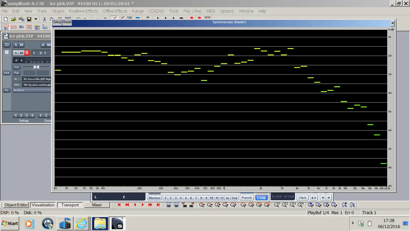

Ok, attached is a "sum of the peaks" of most of the clip.
You can see I think that there is a lot of energy in the 2-3kHz "presence region (where I still have some hearing) but there still a lot of signal up in the 5kHz range. There is also a dip at 400Hz'ish, not sure what that means but it IS around instrument fundamentals?
Now, I am NO! Mixer but suspect that is not a good result?

That is awesome!
You definitely have taught me something major here about EQing. Thank you for that!
