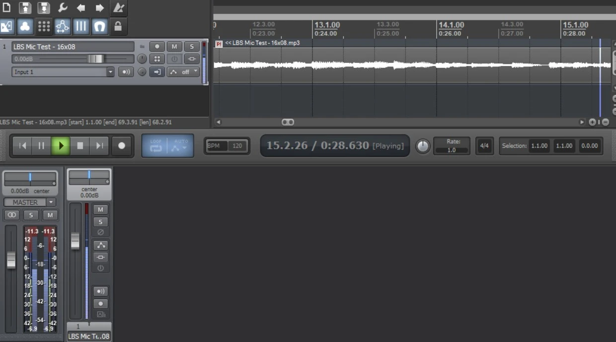

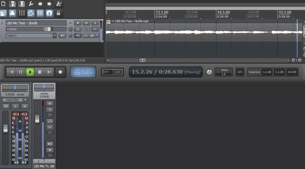

OK, I forgot how tricky it is to get things off the AW1600, but I've got it recorded.
Here's the comparison of the Zoom R24 at 48K/24 bit vs the Tascam 16x08 into Reaper recorded at 88K/24b and both rendered to 256K MP3 at 48K. I had to tweak the volume settings to get them close. It looks like they're within about 1 or so dB to each other.
You tell me if they are closer than your Apollo and the DP24. Mics are Sennheiser 835s about 18" from the end of the fretboard of my Taylor 310 with light gauge strings.
  • LBS Mic Test - 16x08.mp3
  • LBS Mic Test - R24.mp3
TalismanRich
LB, I've managed to move the file out of the AW1600, and adjusted the volume to be close to the others. The Yamaha was quite a bit lower in level than the other two, so I had to bump it about an additional 4-5dB. You might hear a difference in noise floor. Here's the resulting file.
Something that I found interesting was that in total, I did 17 minutes of recording. Of the three recorders, the AW1600 was the fastest. The Tascam/Reaper was .07 seconds slower than the AW, and the R24 was .12 seconds slower than the AW. I found that interesting. Also, the phase was identical on all three recorders, which is a good sign. I didn't use any EQ or effects, just volume adjustment.
  • LBS Mic Test - AW1600.mp3
Well its good that it sound similar. Differences in gain is expected. No ice pick effect. Really nice Taylor sound. Not my crap plastic ovation that was cool when Skid Row was popular..
A moderate level recording . Modest , but very clear. Rich that is what I would want an acoustic to sound like.
