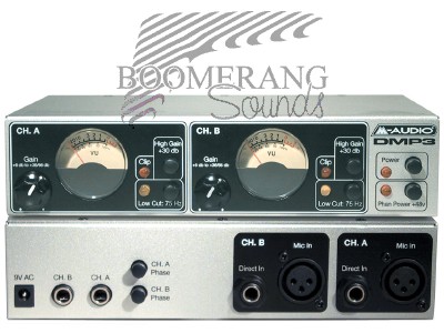

Hitting both that phantom power button and the high gain button result in an increase in gain for a SM57. SM57s are dynamic and don't need phantom power, but if you crank more juice through it, the line signal's going to get hotter. at least on my rig. i could be wrong. i'll go home and check tonight.
Yer i could have sworn that it did with mine!
The way this reads, you are pushing both the phantom power AND the high gain button, and attributing the increased gain to the 57 getting phantom power. That's like stepping harder on the gas pedal while simultaniously turning up the car stereo and saying turning up the volume made your car go faster. Also, the increase in gain isn't in the 57, it's in the preamp.
Phantom power is applied to both pins 2 & 3, which on a balanced mic means that there is no potential created, and no current flows. So, you're not cranking more juice through it.
ok, when i get home it's test time.
hi gain button off, phantom off - the way i usually have it. volume on the SM57 is fine.
I'm going to leave the hi gain button out of this, so nothing can be attributed to it.
i'm going to hit the phantom button. if there's any change, i'll let you guys know.
i got home and hit the phantom power button. no change. SM57 isn't affected!
I will refrain from the "I told ya sos".Except for this one.

SheppardB your right, at least i think so. I will try it out again when my mixer comes. could it be possible that my xlr cable is wired wrong IF this actually does work?
