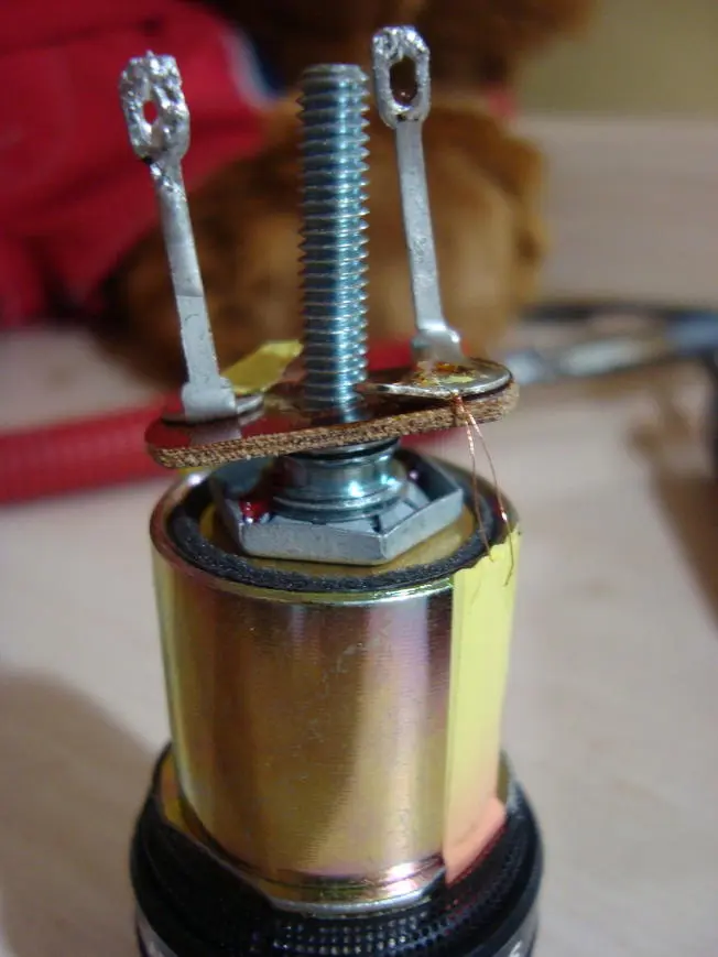

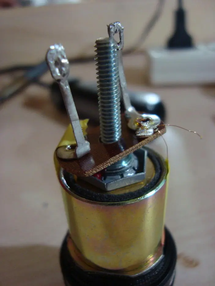

Check out the guts of a 57. This is the reason your mic isnt working if its not the soldering points. Notice the broken wire, its tiny tiny tiny.:D
