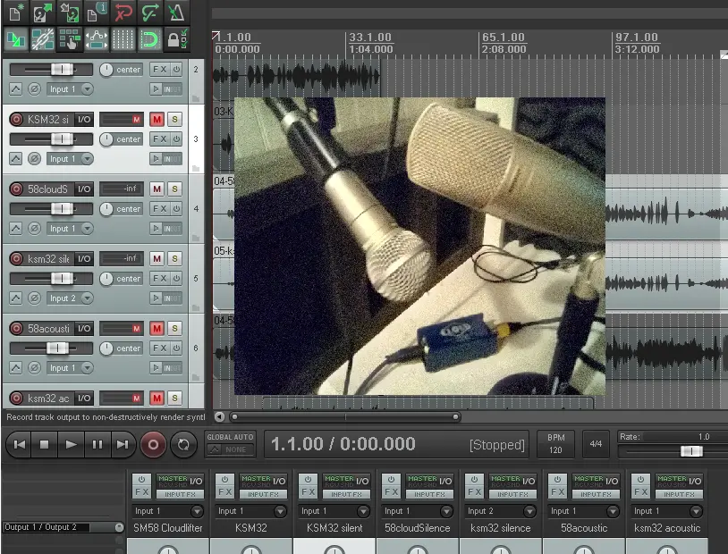

Review of SM58 vs a KSM32 in a small room HR.

A) The SM58 is a new one, 50th anniversary actually, plugged into a Cloudlifter. So in all fairness a $250 setup.
B) The KSM32 arrived this second time, as a mint condition, amazing deal (Im a sucker for great deals even if I don't need the item)…A used Mint KSM32, a newer one, for $250 with Shure box, nice airline case, shockmount, standard clip and velvet pouch.
Test 1: nothingness...noise floor...my interface preamps max'd and the KSM32 was silent. Very impressive.
The SM58 not so silent. I assume its the transformer or something. Im not talking noisy, cant use it, but this is a tech-silence gearhead test and the KSM kicked the SM58's + CL-1, a## in a big way when splitting audiophile hairs. YMMV... :D

anyway...heres some very short clips of A & B, $250-ish range. Dynamic and LDC/MDC?..
Clip is A-SM58 & CL1 silence test the intiial (2 to 7second), KSM32 silence, (at 9-13second)
silent but can hear the dogs outside...lol
then a brief acoustic SM58 and KSM32...of course moving a mic can do drastic changes this was at the hole...
then a snippet of a recorded demo..same vs 1 and 2.
Sm58 And Ksm32 HR by ccb | Free Listening on SoundCloud
