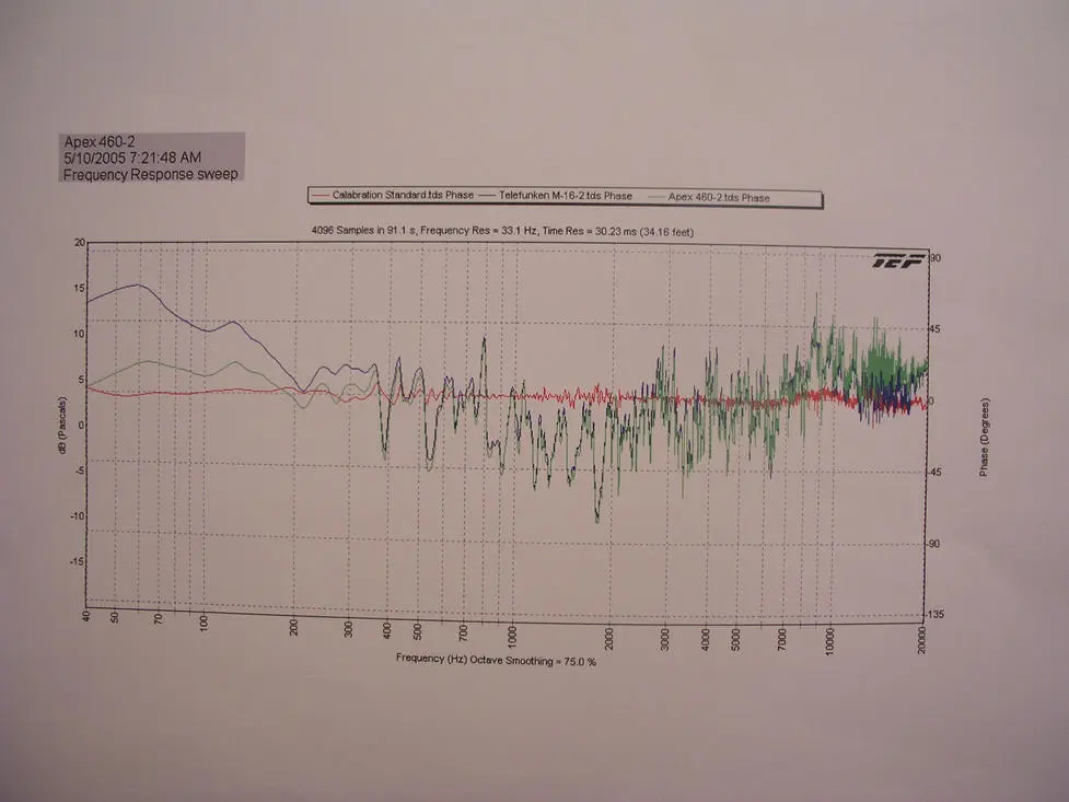

The transformer in the Apex 460 provides unreal phase response problems. If anything, the high end is so harsh because of it. The laminations and design of that transformer are but one of the reasons that mic sounds so bad stock.

The posted 87 curves are for a KH modded one. Not stock
Do you know what what was done to the microphone? did KH change/remove the high end EQ?
