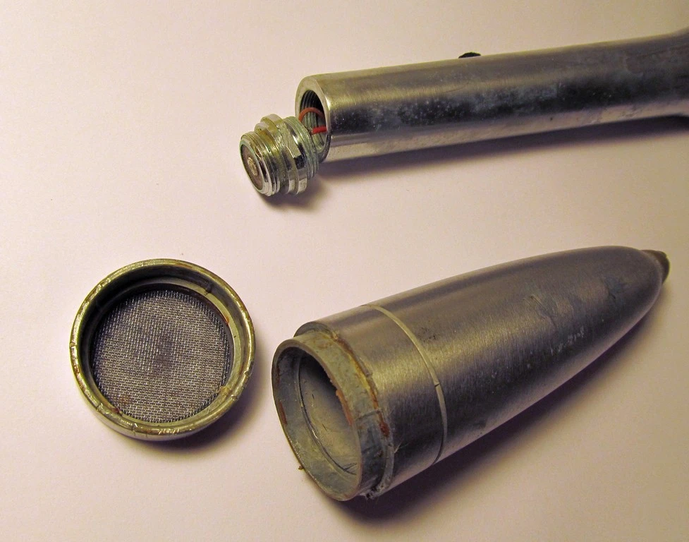

Below are a couple old dynamic mic bodies I had in a parts drawer. No idea of the brand (think the longer one may be a Lafayette Radio). You can see one where the head was kinda glued to the body. The other one does have an end cap that screws in and the cap has flats to get a wrench on to, which I don't believe yours has. This doesn't really help you specifically for your Shure, but gives an idea what was done on some mics.

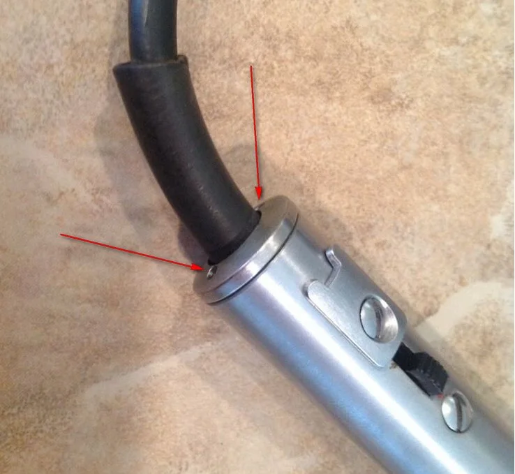

Attached is a picture of the 578 that shows the cord area and the bottom a little better. Any ideals would really be great. I don't want to damage the microphone. As I mentioned the mic works great .The cord has gotten so stiff that its difficult to use.
Dad RoadieView attachment 98022

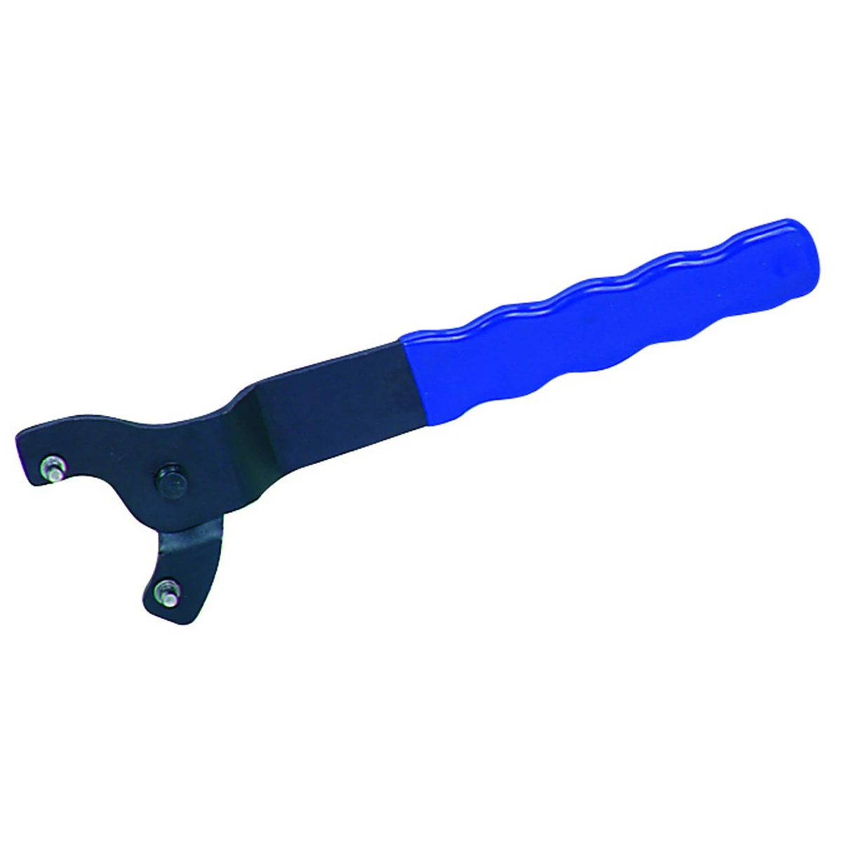

I did some searching and found an image of the backside of the cap. There are two dimples that are made for what's called a 'spanner wrench' (image below) that grabs those dimples to unscrew it. If you have a pair of needle nose pliers and if the cap isn't overly tight, you might be able to get it off using the pliers tips in the dimples. Be careful not to slip and poke yourself with the pliers (I know this :) )
