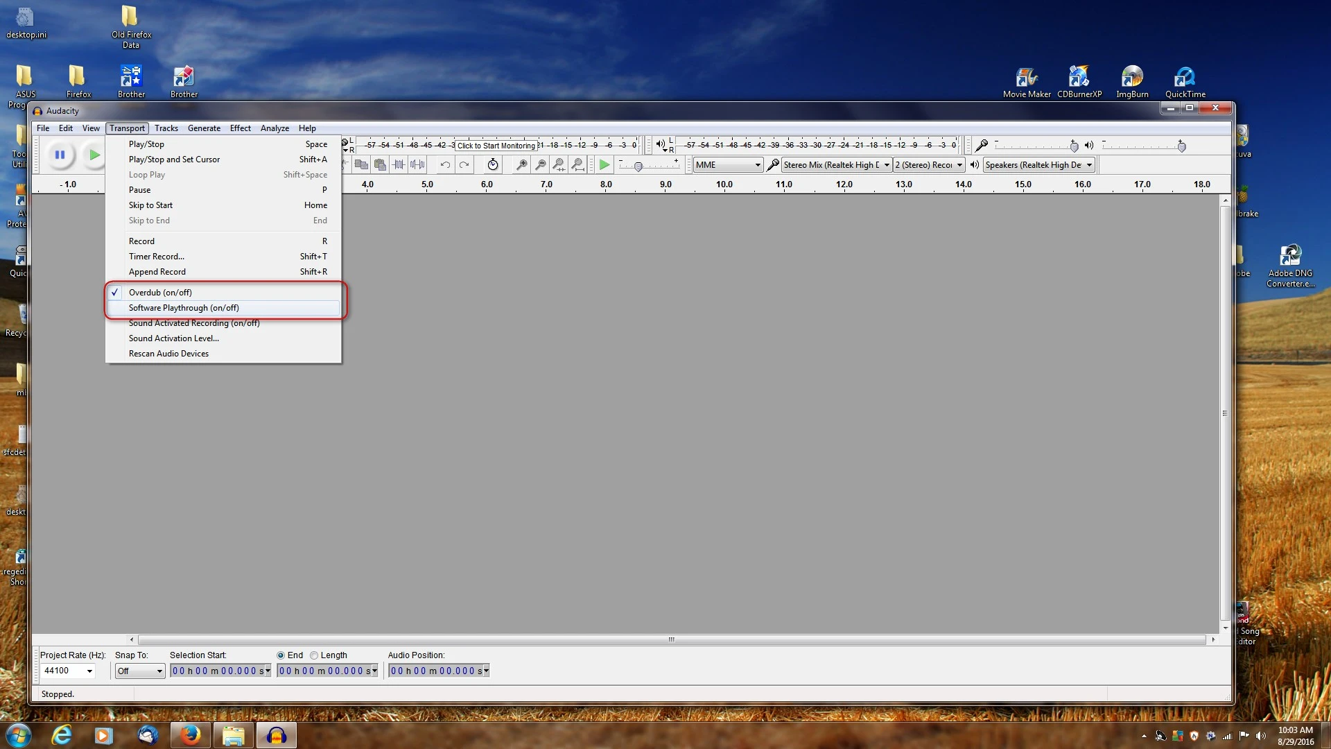

When you 'upgraded' to Win10 did you check in your Audacity the settings shown below? I seem to recall having a similar issue at sometime in the past that was affected by these settings.
