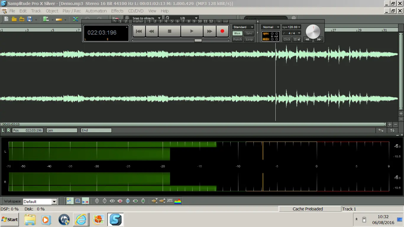

Average at -20 to -18ish and absolute peak at -7dBFS. It does not really matter "where the knobs are"! If you are getting a clean, noise free result that is all that matters.
See, mics and DAWs and interfaces are STUPID. We can home in on a sound and say "Ooo! Nice bit 'o' guitar" Electronics cannot do that and we are then surprised at how little notice it takes of our magnificence!
I notice (from Anny Lyser, ears are no effing good!) that there is next to buggerall past 5kHz and very little of that. Don't think that is MP3 trashing the signal, new strings mayhap?
