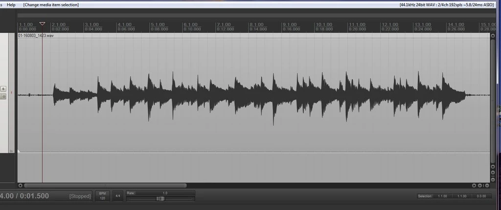

Quickie with an SM57 and Tascam US144mkii (2.2kohm input impedance :) ). Micced about 8" off acoustic midway between soundhole and 12th fret. Chuku had mentioned 'thin' sounding, so wondering how this compares.
Unedited mp3 and waveform as recorded in Reaper.
Just by looking at the sound wave, i can say it is much better than mine. The Mp3 sounds fairly loud than mine with gain 100%.
Just compare with my following sound wave at 90% and 100%. I am unable to attach Mp3 file.

Attached is an idiot on guitar. SM57 about 10" from acoustic* in a very quiet suburban living room around 06:30 today.
In the original recording (24bits 44.1kHz) the guitar averaged only about -30dBFS and so the MP3 has been normalized to give peaks of around -10dBFS. The noise floor is still a very acceptable (?) -60dBFS.
