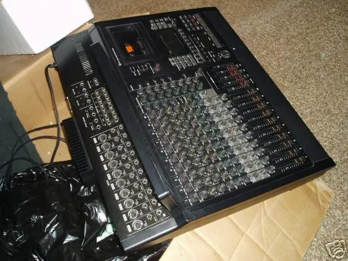

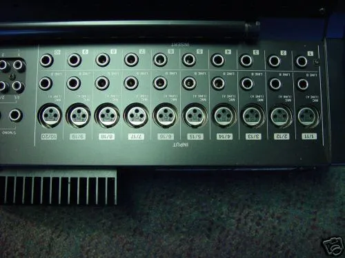

Each of the 10 primary channels has Inserts,...
so I'd use those....................;)
thanks dave, I knew you would be on this...
in the pic you posted, the line input is the input below the XLR, and the channel insert is the input below that, correct?
what kind of cable do I need? When you plug a TRS cable into a channel insert is it both a send/return signal, right? Will an outboard compresor have the same kind of input/output?
Unfortunately most of my effects processing experience is "in the box", or running crappy guitar effect pedals through the effects loops in my 424. So I'm just beginning to learn how to use the more sophisticated mixers, analog/outboard gear, signal chains, etc...
Yes. E'thing's labelled in bold type.
There is a special "Insert" cable, that's TRS on one end, and splits out to 2 TS plugs on the other end. It's a common accessory, on a well accepted standard, so go to your music retailer and find an "Insert Cable". ;)
Insert is just that. There's an In and Out on the same plug on one end, and splits out onto two separate plugs on the other end. It's a Y-cable of sorts. ;)
