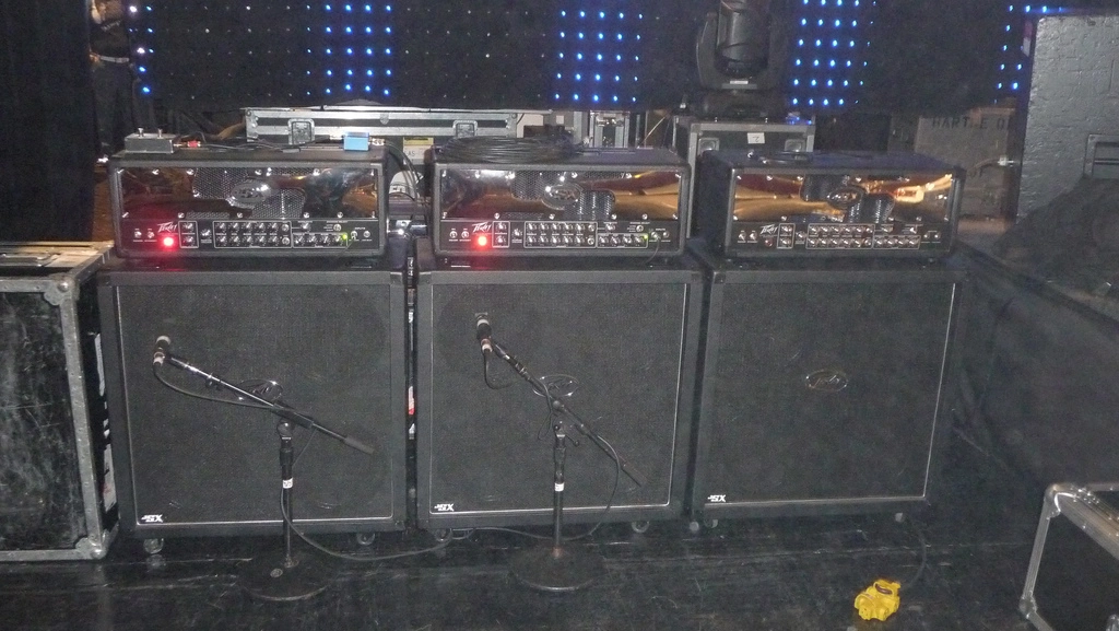

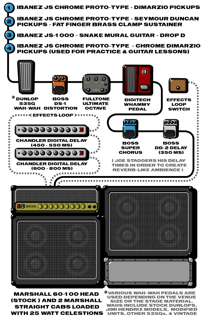

There is so much misinformation in this topic, because I suspect people frustrated with not getting their points across and then make mistakes. Like the sound difference in where a mic is placed. As in mic in the middle is the bassy, dark sound, and the cone edge the brighter harder sound. Earlier on it was stated the wrong way around! Volume up and volume down, then all the cable rubbish which the OP misunderstood and commented on. Guitar to amplifier is length sensitive. Capacitance kills HF. Long cables are possible with care and specific cable types. With mic cables length is pretty unimportant. Long cables do not get quieter. If the op noticed volume differences, then this is a fault. You can put connectors on the end of an entire drum of mic cable and not hear any difference whatsoever. You can measure it, but that's not the same. The OP insists on using distant, and I think we agreed he really means dry. I can't believe we are trying to explain why a 57 on Joe satrianni's speaker cab sounds different to the OPs. It's so obvious!

Ummm.... pointing the mic in the center is brighter, not darker.
Yes, once you get to the edge of the speaker it does get thin again, but that's because you aren't pointed at the speaker anymore. The further away from the center you move the mic, the darker the sound gets.
