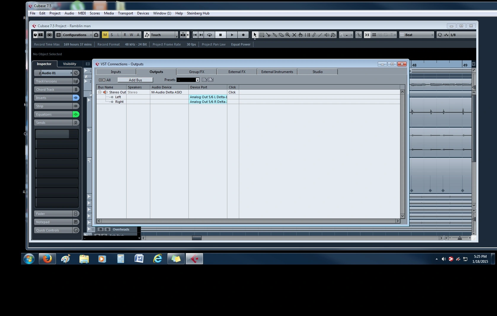

When In Cubase hit F4 this will prompt a new window that has tabs labeled "input" and "output". You have the inputs selected correctly as you have recorded audio thus meaning it must be your output. For example I run a Delta 1010 soundcard, so I must change my output settings to my monitors, headphones, summing mixer etc. I have presets, the monitors will be stereo out 3/4L, 3/4R hopefully you get the point. Here's a pic VST Connections.jpg Also make sure that your actually audio track it routed to your stereo out.
