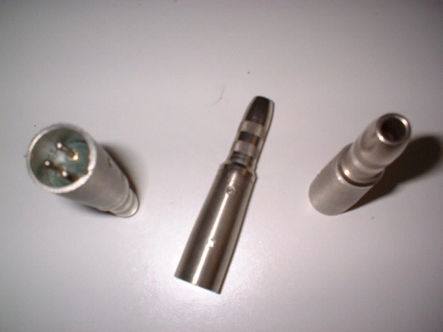

You may also route the electric guitar through the preamps by using the proper 1/4"(F)-XLR(M) adapter, to give the electric guitar signal some boost.

A guitar pedal may also be used (inline) for purposes of preamp, overdrive & effects, if you like. Pedals generally plug into the 1/4" jacks. As above, you can also use XLR inputs (with proper adaptors), but you'll have to be more careful about not driving the gain stage of the XLR input (preamp) too hard.
