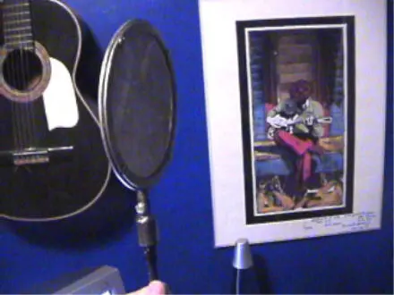

Ok I went to the hardware store first and got some screens, which was not bad. then looking forwire cutters to shape them I ran across a filter for a vacuum, not a bag but the huge filters. I noticed that there was a wire mesh on the inside and I took it apart and am cut out the circle for the pop filter. Right now I just need to find a mount for it. But it will work.
Pray for me!
ok, hope this works, here are the pics of my finished dealy. Man it works good. If you can't see them, I'll email them to yall.

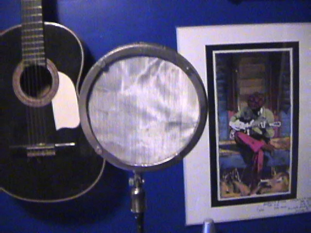

ok, here's another

They kinda ghetto and not straight, but very cool nonetheless! How much did you spend total and how long did it take you to make them? Also, where are you hosting your picture files?
looks great!! Did you customize the holder? Where did you get the parts from? The iron holder looks really familiar, but I can't remeber where I've seen it.
