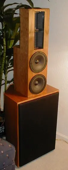

My open baffle speakers with Heil air motion transformers, Audax midrange, and Dayton Titanic subwoofer. All woodwork I did myself and used natural cherry veneer. It was a cost no object project for my customer. Triamped with four my tube monoblocks for top and mid, and SS for bass. Passive LC fourth order crossover, transformer output coupled tube DAC etc. This system I designed myself and it sounds amazing. The power tube amps are 6550 output cathode followers with interstage transformer driven by 6B4 (2A3 with 6.3 filaments). I used Dynaco Mark III trannies and chassis. Cannot find the picture of the amp right now, but here is the speaker:
