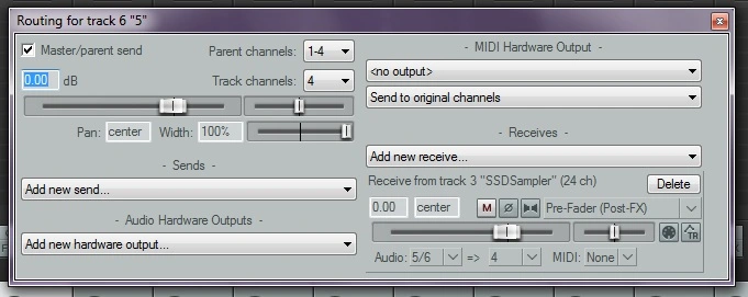

When I right click a channel fader, I get
Don't know why you would get a different box...
OK, you guys are getting me close to what I want to do. Mr' Clean's screen shot helped. I first had to go to Preferences and change the "Last output" to 3, and then go back to the channel output and assign the track to channel 3. So, now I don't hear the guitar track in the mix, which is good. But it's not getting to the amp, which is bad. But we're getting closer. :)

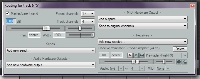

I don't get a different box. But I don't see the same thing at the bottom of the right hand side because I don't have SSD or anything else as a Recieve. Other than that, I'm getting the same box.

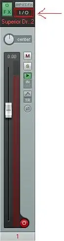

I always set up 2 tracks to record at the same time, a di and an amp'd track...I always kill the master out on the di, so I don't hear it at all, what I hear is coming from my amp...you can ALT/CLICK the I/O button on any track in the mixer to kill the master output...But, since you've gotta set up a new hardware output, it's just as simple & easy to untick the master out when you add the new output...
