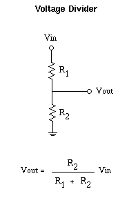

Does this help? Your reply in the other thread was a laughing face, but...
Impedance matters exactly because
there's a voltage divider created by the connection. In this image, your source's out-Z would be R1, and the load's in-Z is R2. I think it requires only a grade school level understanding of math to see that Vout goes down as R1 gets bigger with respect to R2, and that if we want as much voltage out as possible then R2 should be a whole lot bigger than R1. If R2 is ten times R1 then the output voltage will be 10/11 of the input, which is less than 1db down, which we consider to be negligible, and thus the 10:1 rule of thumb.
But this is for purely resistive components. If either the output or the input include reactive (inductive or capacitive) components, then which ever "R" they represent above will actually be frequency dependent. Most active devices can be considered to be purely resistive because any reactive part of their impedance contributes very little in comparison. We can't go too wild with this, though, as there usually is some largish capacitance in series (AC coupling capacitors) with R1, which gets bigger for lower frequencies, so that if R2 gets really small, we can lose bass response.
The cables we use to connect our equipment are capacitive, and in parallel with R2 such that R2 gets smaller for higher frequencies. Therefore, if R1 is very large we can lose some treble.
A passive guitar pickup has a pretty large resistive component but is also very inductive. Therefore, R1 starts kind of big and then gets a whole lot bigger at higher frequencies. Therefore, if R2 is smallish, we lose a lot of treble. Of course, in most passive guitars, R2 is actually more like the parallel total of the values of the pots in the guitar, so the math gets a little tougher, but basically we want the input-Z to be as big as possible so that the Vs and Ts on the guitar itself are the main factors in the overall tone. As for this assertion that most people can't tell the difference between plugging into a 1M vs 56K, well...most people are dinks. For most passive guitars, there will be a pronounced difference in the top end. I can't imagine anybody would argue they don't hear a difference when they turn their T knob down to 6...I suppose, not everybody really wants all of the treble possible out of their guitars, but there is a big difference.
