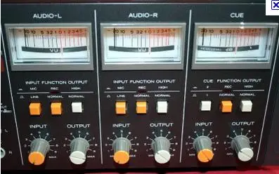

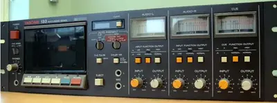

See the attached pictures labeled with 133 to see this unit.
My question is, if you playback in stereo, wouldn't you hear the guitar only in 1 ear and the vocals in the other? There does not seem to be a means of pan adjustment.

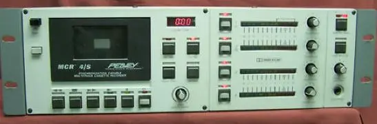

Also, this conundrum exists in some four track recorders as well. See the attached "Peavey MCR-4S"

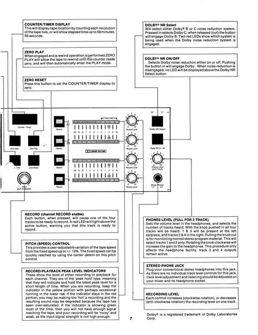

In the owners manual (last attachment labeled "Peaveyrecorder..."), it states that can monitor either 2 or 4 tracks at once, and that tracks 1, 3 will be heard only in the left earpiece and tracks 2, 4 will be heard in the right ear piece. This seems silly because it doesn't seem very useful to have a machine that records each track hard left or hard right, so that you have guitar in 1 ear and vocals in the other. Actually, I doubt this is the case, I just don't understand the way it operates.
