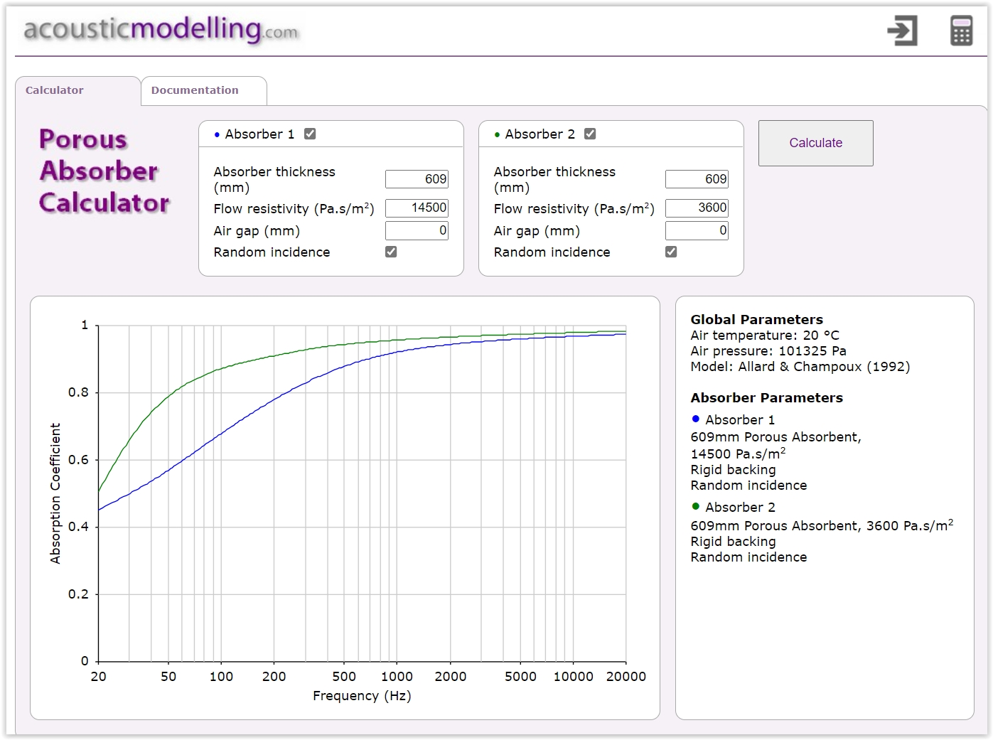

So lets say you want to build a bass trap 2ft thick. Here is a chart with two different fiberglass products. Which would you pick?

So both are Owens Corning fiberglass. The blue is 703 at 2ft thick. The green is cheap Owens Corning Pink insulation available at Home Depot also at 2ft thick. To be effective your choice should be at least .75 at the frequency you wish to treat. The pink fluffy stuff is at least .75 effective to 40hz vs only 300hz for 703.
703 used to list a .85 rating at 125hz. The updated rating is now .63 at 125hz for 4 inch thick. Think about this. Great maybe if you only have 4 inch panels. Compare how it performs in this graph at 24 inches and you see what I mean. Going thicker, doesn't gain much of anything. Now if I measured 4 inches of the pink fluffy stuff, the 703 beats it handily. At 24 inches for both, pink out performs it by a mile. What I had to do to compare these, involved looking up a few specifications and running a online calculator.
In going over my pre-construction notes, here is another comparison OC Pink with Safe N Sound RB40.
