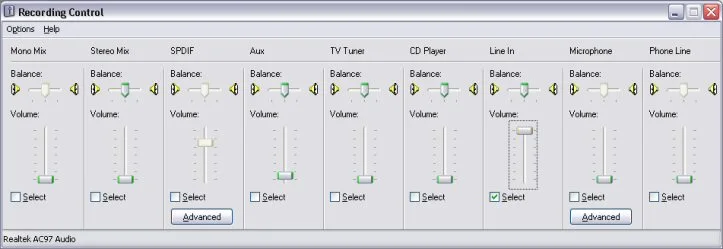

Double click the little speaker down by the clock.
Click Options .... then properties .... then select "Adjust volume for" "Recording" .... place a check mark at all of the selections for "Show the following volume controls" ... now click OK.
Now make sure Line In is selected with a check mark. You may have Stereo Mix selected instead of Line In. That would cause the bleed, unless you are using a mic and it is capturing the metronome from the speakers or leakage from headphones. My guess would be that Line In is not selected.

If you followed my above directions exactly and the Realtek is the only sound device in your system .... your Recording Control mixer applet should look quite similar to the picture below.
If in fact you are setting it correctly and you still get the bleed of other audio ... Then the onboard sound chip (Realtek AC97) has some serious flaws. Only to be corrected with a new soundcard.
