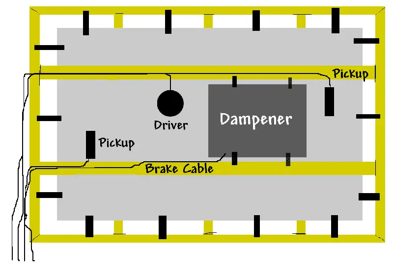

Yeah, I thought the wood might be too weak. But if the 2x4s were parralel to the plate instead of perpindicular it would be stronger. And put a few crossbeams on it too. Sort of like this I just made in Photoshop.
And I figured maybe piezo acoustic guitar pickups might be good? Especially if it has a built in preamp.

I really couldn't tell you for sure. The only plates I have used have been old EMT's that were installed in the rooms I was using. I know they sound great, and I have read the same article as you.
Guitar pickups seem a bit expensive to me, particularly since you would still need to use a DI with them. But experiment. I just don't know.
