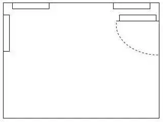

part of the problem is that at a perfect right angle. a 2' panel will requre exactly...1.41 feet or 17 inches on each side and I only have 13 inches in the back coners before I run into a door and closet respectively. and that is on the ceiling/wall corners. the wall/wall corners are totally not-doable due to the door and closet. so, I could do full sized ones on the front-wall corners in my control room and call it a day. and I could do them on all 4 corners in my jam room but I still think I would lose a lot of jam space for what looks like a small improvement...

Try hanging a panel on the door and one on the adjacent wall like this. Then do the same for the other side to keep it symmetrical.

Falken,
> a 2' panel will requre exactly...1.41 feet or 17 inches on each side <
Yup, so either shave a few inches off (versus removing a full foot) or do what I recommend all the time to my customers in the same situation: Angle the panel a little so it's not quite 45 degrees. A panel that's 2 feet wide and straddling a corner at 30 degrees beats a panel only 12 inches wide that's perfectly centered.
