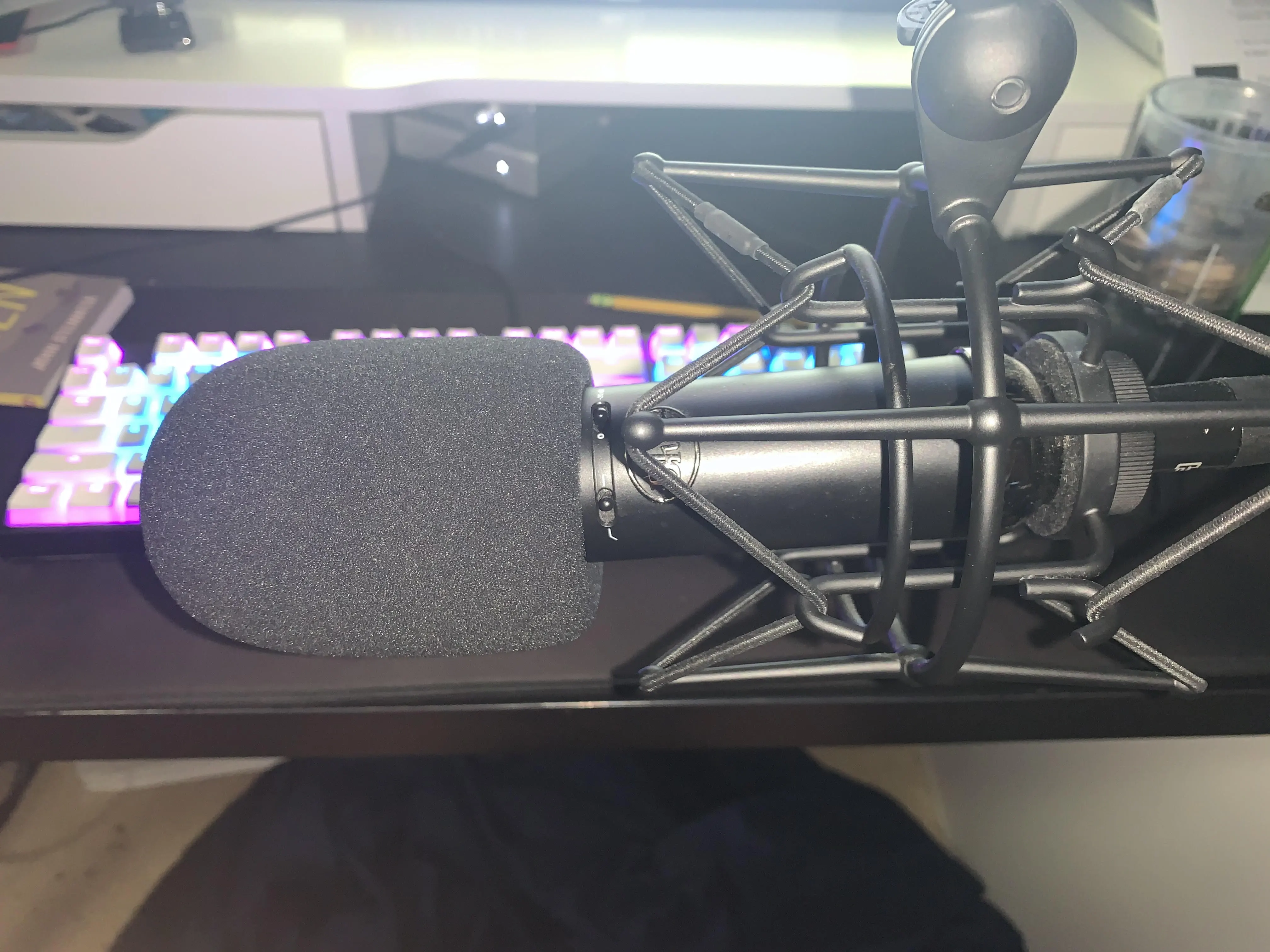

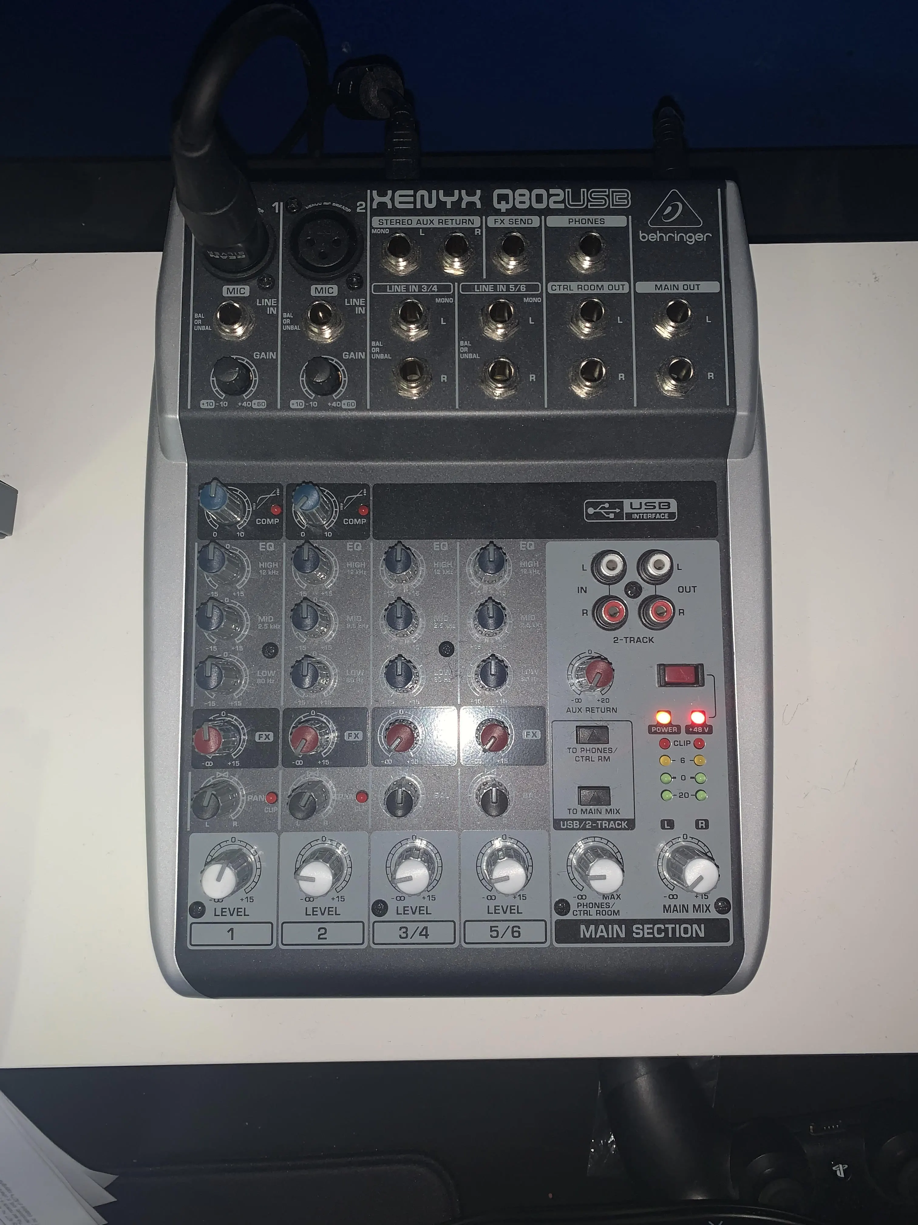

I spent a lot of money (for me, I've seen mics on here that are thousands of dollars, got mine for $200) but it doesn't sound as good as I expected and just has so much buzzing and interference. I'm running a Blue Blackout Spark SL plugged into a Behringer Xenyx Q802 USB. Attached are photos of my equipment and levels. Attached is also an audio recording of what it sounds like + photos of the setup. I'm unsure if it's just a settings problem or if there's something with the cables. My XLR cable is quite long so I think I might replace it anyways, just wanted feedback before I do that. Thanks!

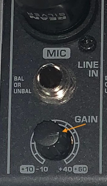

I have a Q1202USB - well, I gave it to a local yoga studio - and it's not noisy like that. I was surprised that the channel level on that does affect the USB level, so make sure that's Ok and not clipping. Does the MAIN MIX level affect the signal at the computer? I honestly can't remember. If it does, you need to turn that up some, as well, and probably bring down the gain - the "2:30" setting I see in the image seems high for a condenser microphone. I remember plugging an SM58 into the mixer and that's about where I had that, so excessive gain would really amplify the mic noise.

Where is the 2:30 setting you're talking about?

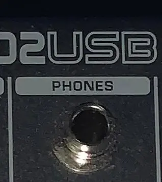

You plug the phones into the jack labeled PHONES in the upper right corner.

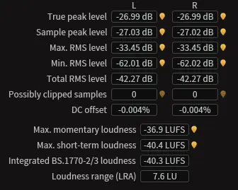

The audio file you have attached is recorded at an incredibly low in level. True peak is like -27dB, so you are missing probably 15-20dB gain somewhere.
p.s./edit: It's more of a whine, and suggests electrical interference. Possibly from a shared AC line, bad adapter, or originating in the computer. Upped the file 15dB here.

Set everything on the channel with the microphone to zero that has that number on it, and set the pan to dead center. Set all other channels' gain to -10 and level to -♾. Set the Main Mix to zero. (And by "zero" I mean where you see the number "0" on the dial.)
Make sure phantom power is off, plug in the mic, then turn it on.
Unplug the USB cable from the computer and listen with your headphones plugged into the mixer. Turn up the PHONES/CTRL ROOM level until it sounds good when you speak into the microphone at a normal speaking voice with the mic about 6" away. Do you hear the whine? If so, then it's in the mixer, and maybe coming in from the house power/mains. If you still hear it, it's time to start flipping circuit breakers to figure out what is introducing the noise. (Maybe start with turning the computer off!) If you don't hear it, then plug the USB cable in and see if it comes back when you do the same test. Record this part if you get to it, and post the MP3.
