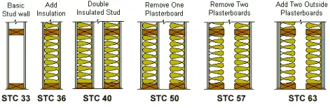

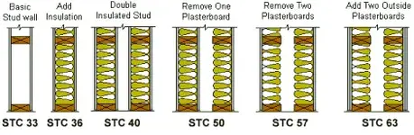

Here is a different STC rating illustration.
fitZ

One thing I forgot to add is this. These are STC ratings, which are a rating in the speaking range, NOT, music. Not only that, these ratings are only as good as your weakest link, which usually are doors and seals, windows, cabletroughs, and HVAC ducting and only if all the joints in the room are hermetically sealed. If THEY are not up to the rating of the wall.....well, guess what happens :rolleyes: You guessed it, the rating drops to an average.

Question in regard to Rick Fitzpatrick's illustration
Hello Rick and Michael :D
As Rick illustrated here:
Do I understand this to mean that even in regard to 'wood' stud construction, (double wall partitions), where one 'outer' wall is built facing the exterior 'OUTSIDE', and in my case where another 'interior' sub wall is built as part of a 'FREE STANDING' room, that it is better to leave that 'OUTER' wall 'WITHOUT' Drywall installed facing the inside NON-Drywalled side of the 'INNER' wall - so that you have 2 exposed insulated walls facing each other??? :confused:

Michael, optimum use of materials for sound isolation is two masses, one air space, period. If you look at the "663" graphic, you'll see that REMOVING material will actually IMPROVE sound isolation, especially at lower frequencies - this is predominantly because the narrower air gap makes this a stiffer "spring", which then couples between the layers better - this passes more sound than if the air gap were larger, and ALL the mass was in the two outside leaves.
Optimum in the case of that graphic (which were actually tested assemblies, BTW) means that (check the 40 and 63 dB walls for this) you can get 23 dB more isolation using the exact same amount of material, just by WHERE in the assembly you place the mass.
This is no joke - I've had seasoned drywall contractors tell me that Resilient Channel doesn't work - in every case, when asked how they used it, they answered that they put it over the existing wallboard and put 1 or 2 more layers of wallboard over it - one even admitted he just "nailed through it", meaning he shorted it completely with nails.
Even the ones who didn't do that, lost any chance of improvement when they added the extra air gap between layers. What they should have done was to remove the original drywall, fasten the RC to the studs, fill with insulation, and THEN put 2 layers of drywall up. These guys told me the stuff actually made things WORSE for isolation - I don't doubt that; the physics are what they are, and that really stiff "spring" that was the 1/2" air gap where the RC was, absolutely killed any advantage the extra layers could have given.
As for insulation, a complete fill between leaves of a wall gives the best performance; even a slight overfill is good, because it causes the insulation to damp the panels' vibrations which further improves the TL, especially at resonance.
Of course, tight caulking is also a must - if it won't float, it won't be sound proof... Steve
