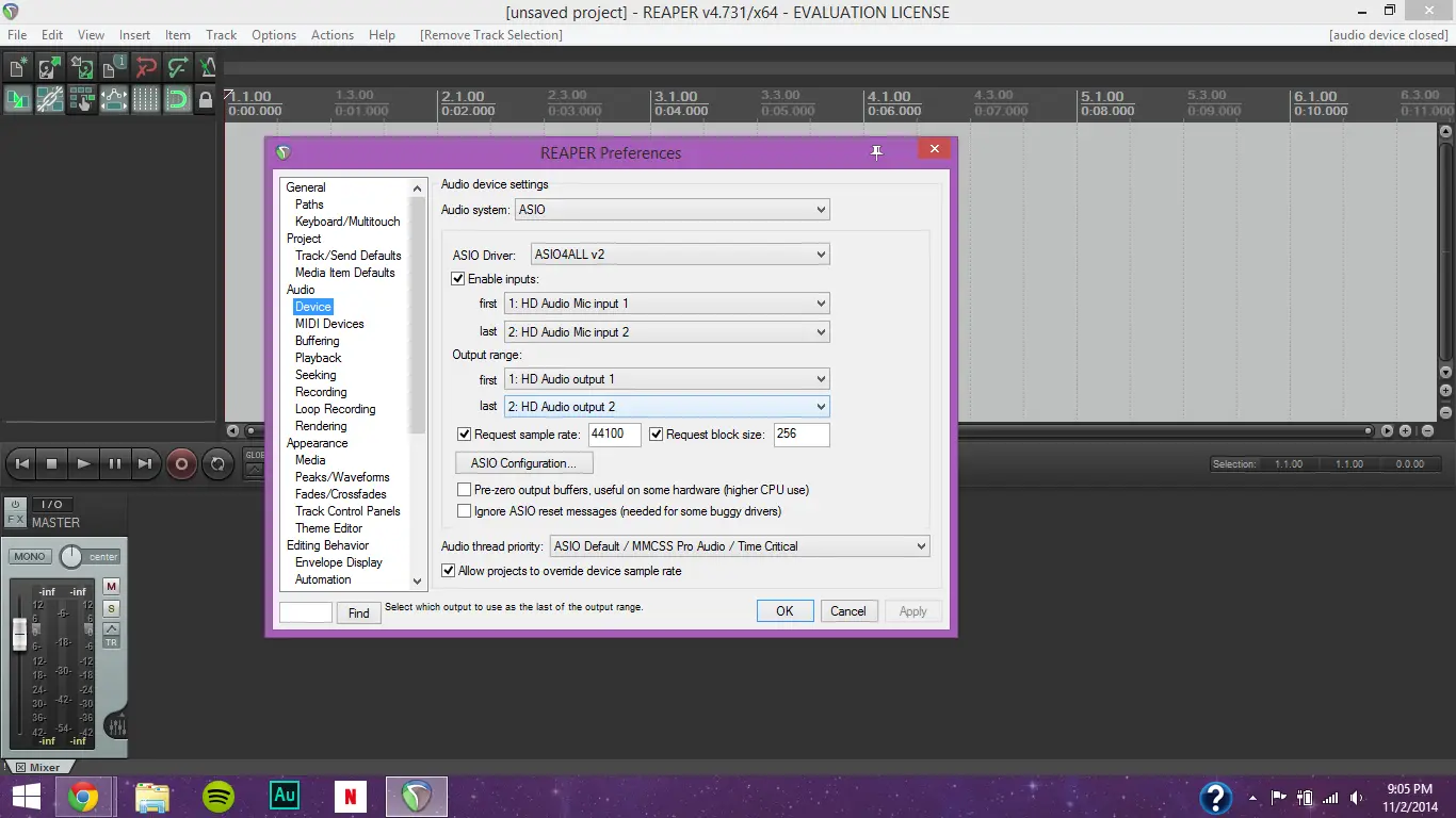

I made sure that all sample sizes match those of the drivers.
Anything looking fishy here?

Here are my prefs
I'm nervous about seeing "HD Audio mic input" on yours.
It's hard to tell whether that is your USB device or whether it's the onboard system
Here are my prefs
I think its because he has ASIO4ALL selected as his ASIO driver instead of PreSonus' ASIO drivers.
So I guess Kelvin should be able to click on the down arrow on ASIO Driver and find a presonus reference of some sort

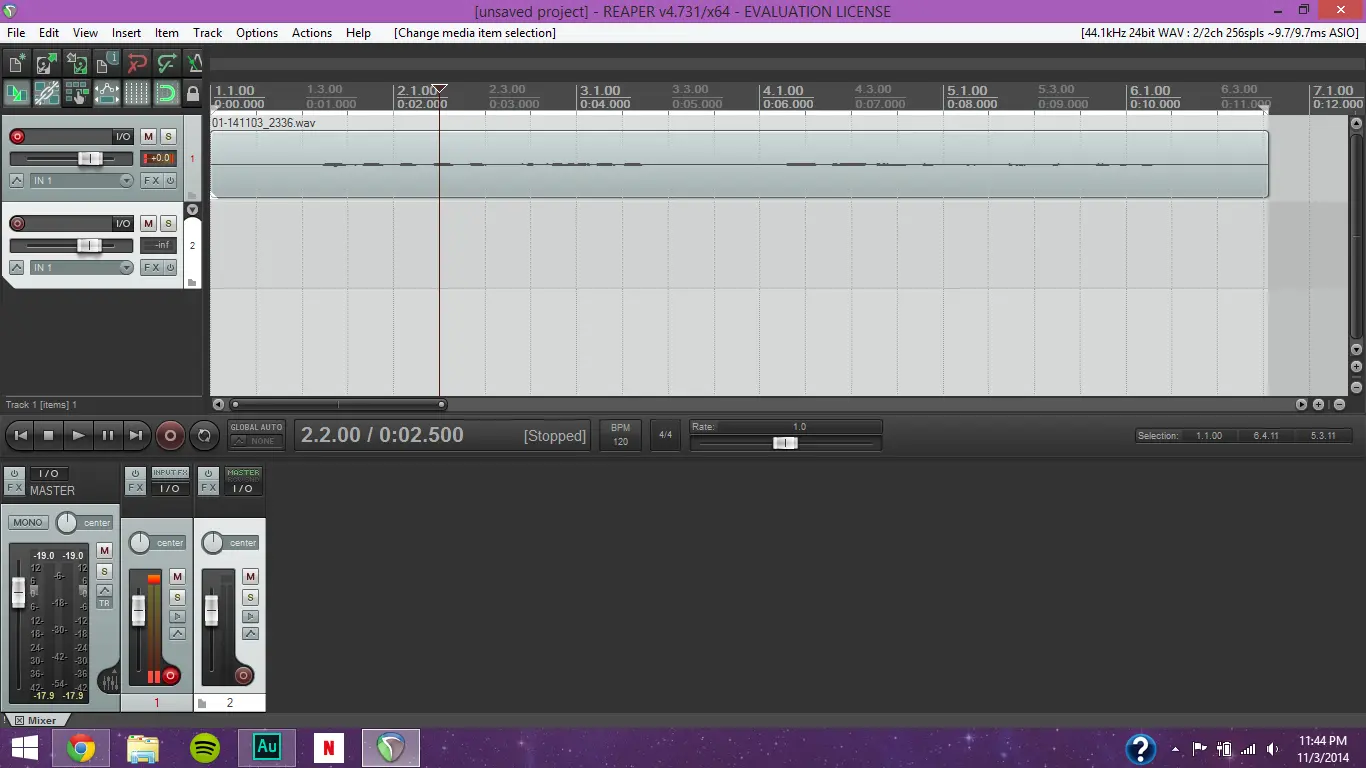

Good catch. I fixed it to presonus asio. But do the levels still look a little low to you? I recorded this at +4 dB because before it was just a straight line. It sounds almost loud enough but why would it be quiet in recording?
The wave form looks low to me. But I notice that it peaked into the red somewhere along the way.
How does it sound? Is there a lot of background system noise? Or does it sound clean?
Where is the gain control on your Presonus set?
For vocals I generally set mine to around 2 o'clock. And, depending on who is singing and the character of their voice, the gain varies from about 12 to 3 o'clock

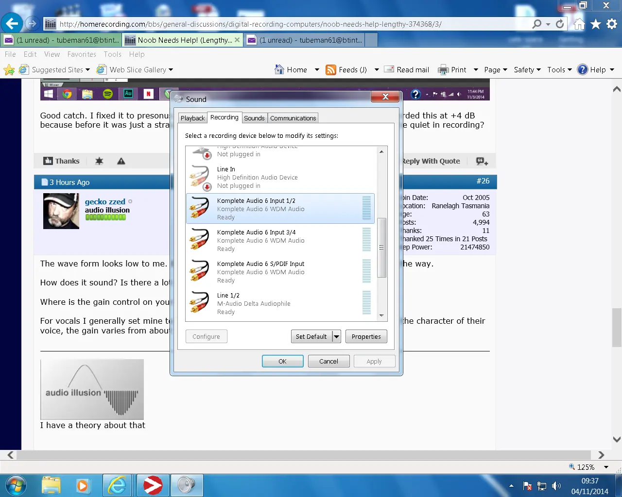

I just wonder why the Presonus does not appear in the Windows device menu?
You can see that in Win 7 at least my KA6 is the named device.

it sounds clean. Its set to 2:30. It peaked because I was trying to see what it would sound like with the gain up. Because I still cant figure out why the wave form is still so low. Its recording at about 23dB. With the gain high on presonus and in reaper. But still very low. This puzzles me.
The gain in Reaper won't help. It's only a playback level control.
The gain is controlled by the interface.
Is there, by any chance, a pad on the mike that's switched on?
