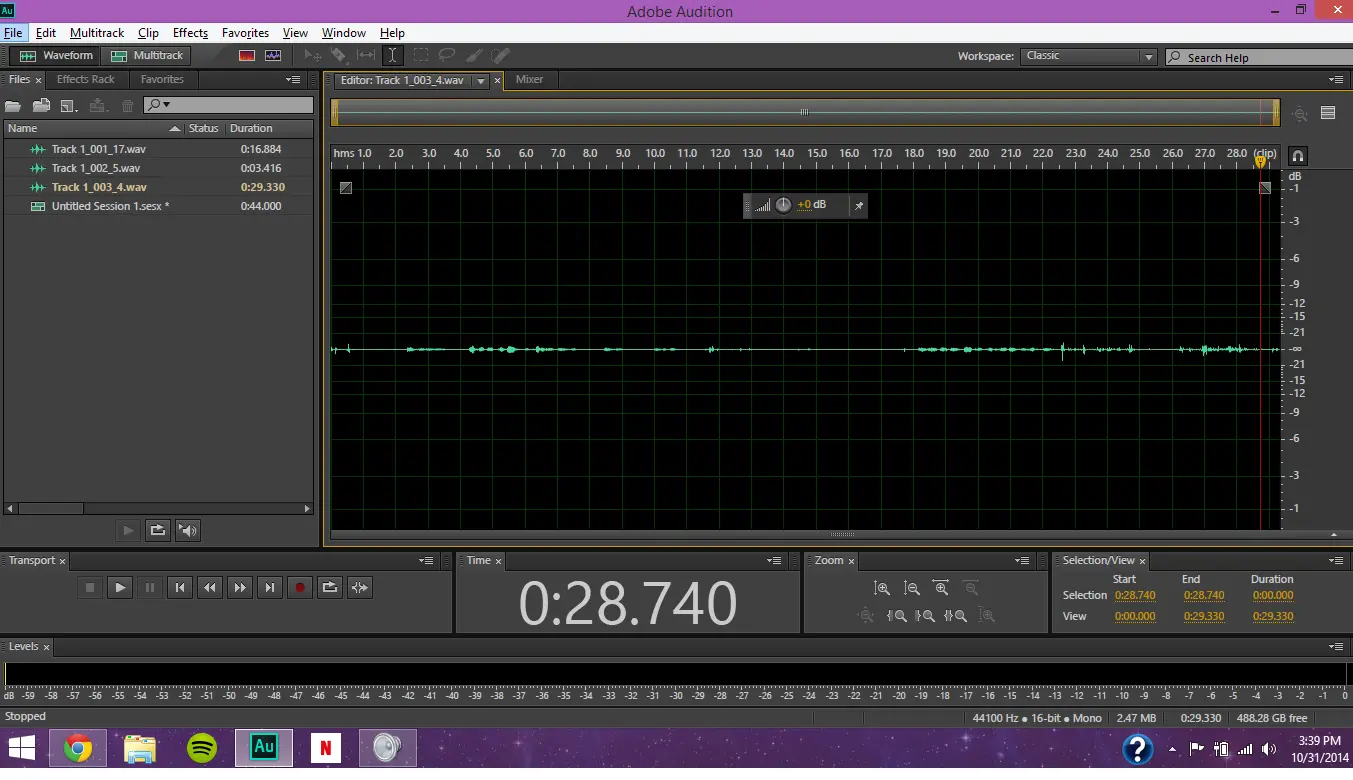

Some screenshots of what im seeing when my mouth is pressed to the mic and talking very very loud. (phantom Power IS ON) And interface gain is at 0-. Also once again mic quality is perfect when monitoring in adobe audition, but when I record the recording is quiet as show. This makes me think the problem is with the computer.

Um, that looks good to me. Actually might be a bit high for input level if Audition meters are dBFS scale.
-18dBFS is your goal when recording digitally. Forget what that little blob looks like on your track. That is only there for editing purposes. It does not represent the actual level of the recording. Well, not as you would think.
Turn up your monitors and do some reading here about signal levels. Do you have monitors connected to your interface?
If you are trying to monitor via laptop speakers, then you will not likely be happy with the way digital recording works... Use headphones.

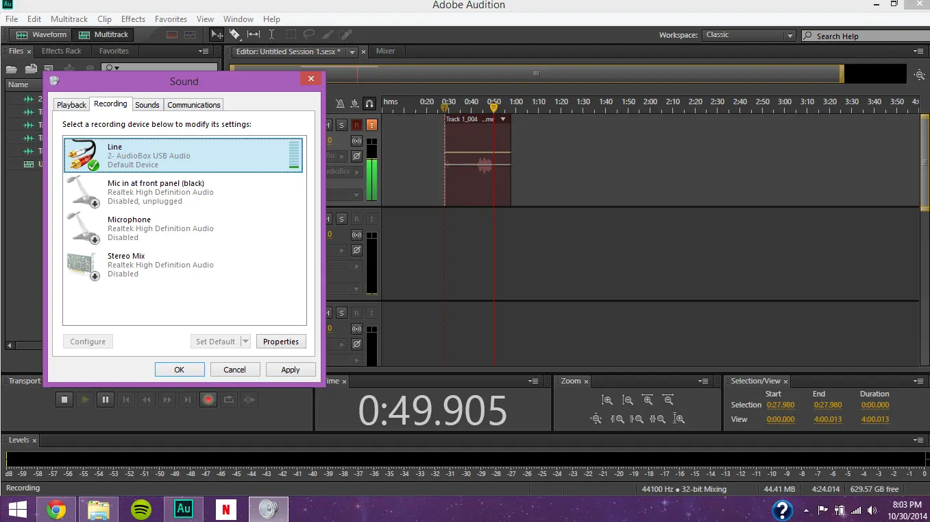

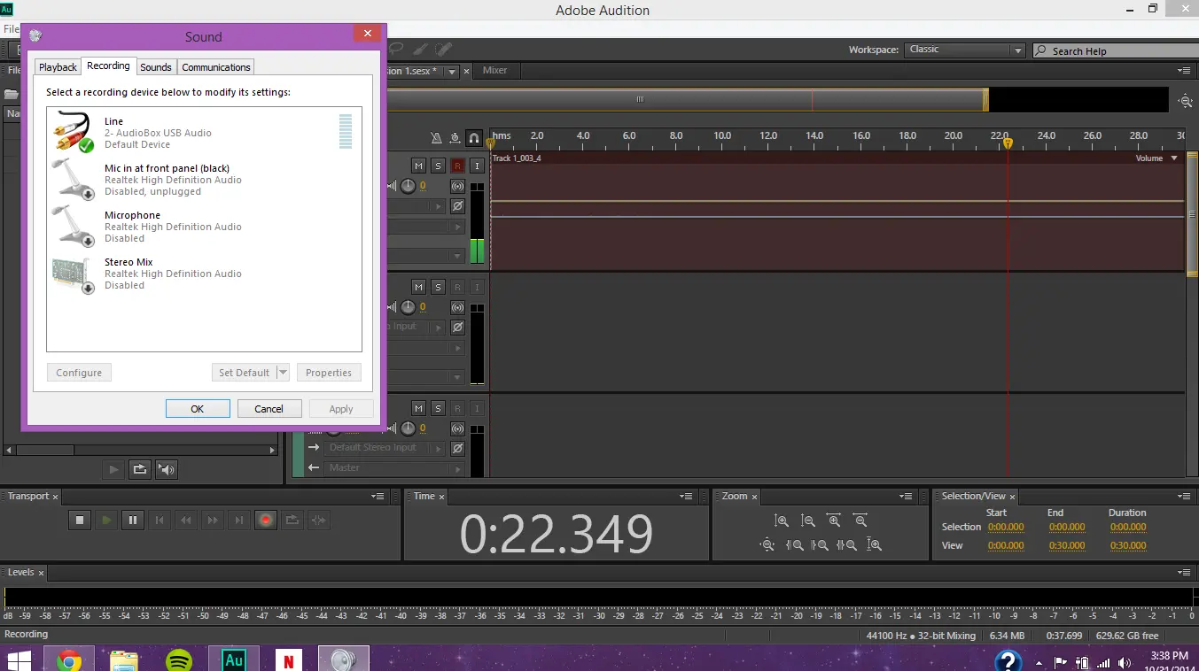

Here is what the levels are like with the condenser mic 6-8 inches away talking at an average volume. Levels seem normal when talking, but when recording the sound recorded is so quiet. And also im not sure why it would sound correct when in adobe audition but "sound" panel is only giving me one bar at most.

In your pic above, Im not sure why the sound dialog box is saying "Line"

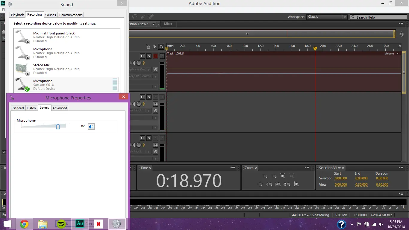

Here is a snapshot of the same case with the usb mic. (Note all sample rates match in put and output) You cant even tell that im talking in this snapshot but trust me i am. Thats how quiet the recording is. So as you can see the problem isnt the interface or either mic.
Also im not sure why its labeled "line" either. I have searched this and could not find why.

Maybe too obvious, but you ARE using an XLR to plug into to the Presonus aren't you? If you happen to be using an XLR to quarter inch adaptor and plugging into the centre of the dual connector, your interface will be expecting instrument level which is WAY higher than mic level. I doubt this is the case because of the need for phantom power but thought I should ask in case there's a funny.
Otherwise, is there a software setting for line/mic in the Presonus control panel? The fact that the Presonus is listed as a line input seemed strange to me as well.
Im using a xlr. No theres no option in prosonus, im not familiar with "line". Can anyone fill me in?
Okay, prepare to be bored because it won't likely help!
In audio there are two "standard" levels, referred to as line level and microphone level. Line level is defined as a specific voltage and is typically the sort of thing you get from some electrical device...a mixer output, a CD player, that sort of thing. In audio terms, line is the working, reference level that floats around inside sound gear.
Microphone level is a lot quieter...typically -40 to -60dB compared to line level. This is why the microphone inputs to mixers and audio interfaces have "microphone pre amps"--very electrically quiet amplifiers that bring the mic signal up to line level to float around the rest of the system. FYI, "instruments" come in at a funny level about half way between mic and line--and the quarter inch jack sockets on your Presonus expect instrument level, hence my earlier question.)
(People like ecc83 will realise that I've simplified and generalised to a huge extent here...)
Anyway, with the difference in levels, if you plug a microphone into an input designed for line level or instrument level sources, you'll get extremely low sound levels because of the lack of the pre amp. What has some of us curious is that your screen shot of your Windows Audio control panel shows your Audibox as the "Line" input--and plugging a mic into a line input would result in super low levels. Chances are this is just funny semantics from Presonus--my two interfaces don't specify Line or Mic at all on the Windows screen, just the make and model of the interface) but seeing the word "line" rang some minor alarm bells.
That's what's worrying me as well.
I've got a Presonus Firepod, which is firewire, not USB, but it doesn't specify "line". It specifies the device.

Actually, that is how my Steinberg UR824 shows up in Windows 7 'Sound' control panel. As Line.
Obviously I have disabled Realtek onboard soundcard via BIOS as well.
I find it odd that W7 labels an external USB interface as Line input. But there it is...
It must be what the device decides to call itself...on my Win7 system, both my M Track and my Profire Lightbridge are labelled "Input M Audio M Track" and "Input M Audio Profire Lightbridge".
