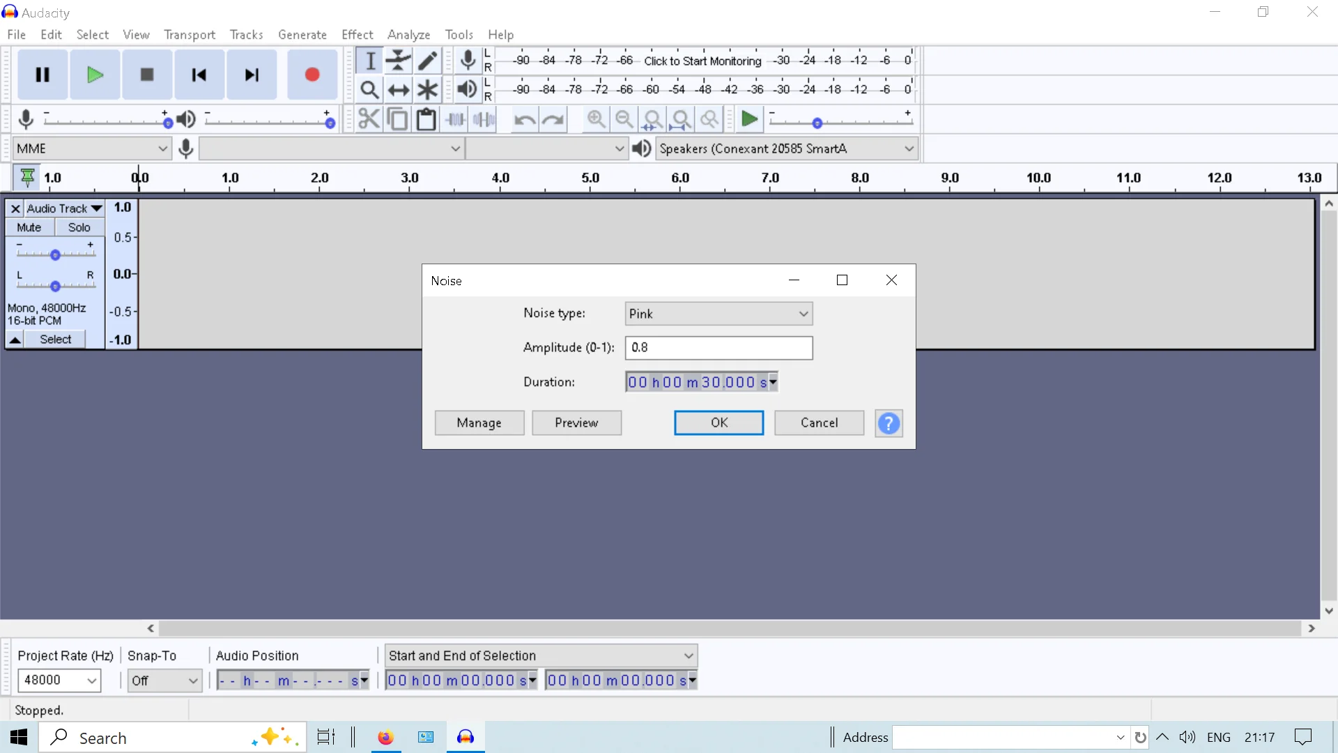

You don't need a third party app, see the screen shot from Audacity, a really useful audio recorder and editor and totally free.
I would also not use a tone for a reference signal it can give misleading results due to standing waves and 'phase' issues. Constant tones also drive you potty! Although you can't measure noise accurately without a true rms, wideband meter but you don't need to. All you need is to ensure that you use the same microphone* with an SPL meter at the same distance and set the same SPL. I suggest 93dB? Any guitar combo should put that out.
Use that setup for all the preamps and you will have a consistent input signal. You still can't get a gain figure but if pre A delivers XdB more signal than pre B you know A has XdB more gain and can correct for that in the noise figures.
If you want to learn more about valve circuits find Merlin Blencowe's book "Tube pre amp circuits for guitar amps". Don't fuss the "guitar" part, the book contains a wealth of knowledge about the design of valve pre amps from basic data sheets. Maths is very basic but I seem to think a bit of math won't faze you?
*If you wanted a pretty decent, "throw away" dynamic mic to dedicate to the task, the Behringer XM8500 is very cheap but there are even cheaper ones on Zon. BTW 440Hz is 773 mm. A distance where hard, reflective objects might lurk!

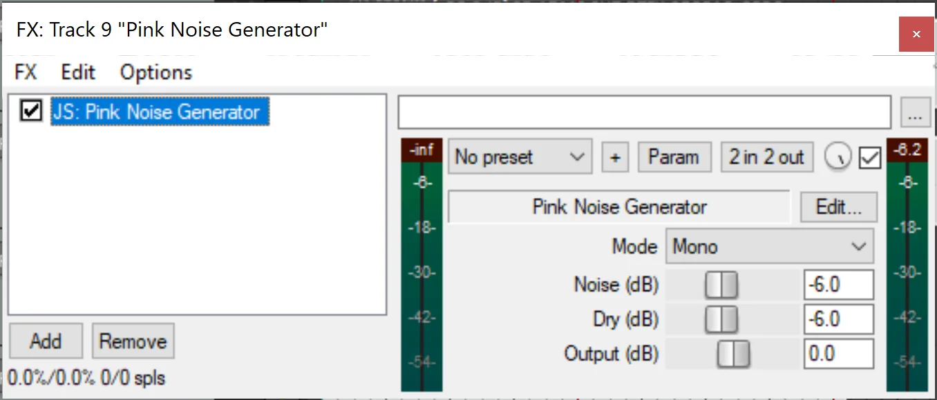

Thank you very much for all of the info. I looked around in the Reaper VST library, and it appears there is a JS "Pink Noise Generator", which should be a good starting point (y) And yes, you are correct.....I have no aversion to math :-)
