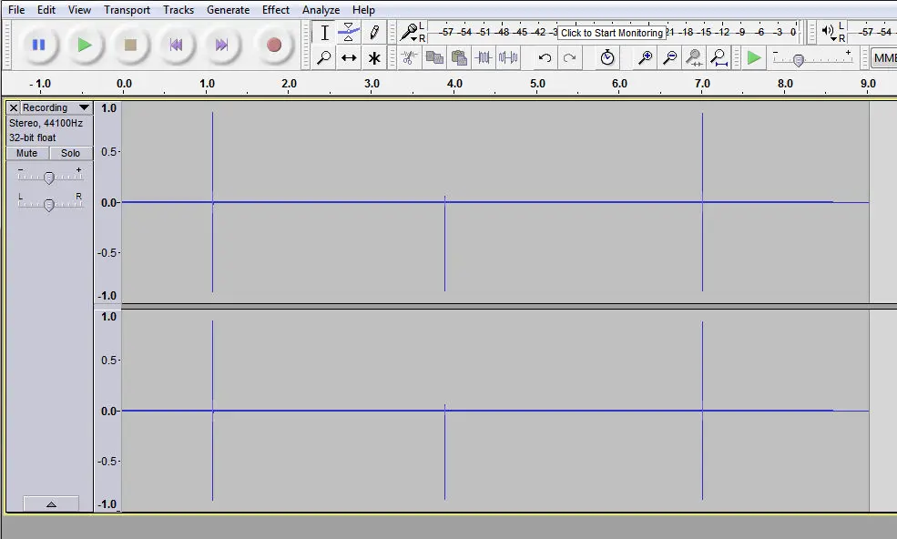

I hear a regular click, which is not nice.
Try recording with:
1 nothing connected to the interface (no mike, no cable)
2 just the cable
3 with the interface disconnected
Does the mike require phantom power?
If so, try recording with the phantom power off.
The purpose of trying these things is to see whether the source of clicks is within the computer or external to it.
DAW with a really slow metronome/click track enabled??? Does it repeat loud to softer on each hit?
I've known similar things when the buffer-size is off-whack, but I'm NOT saying that's what it is... just something to check...
