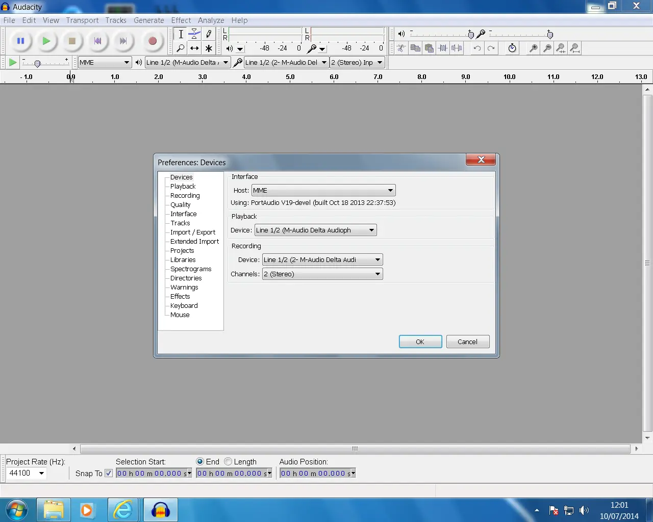

Does your Audacity Device Setup look like the attached?
Naturally the name of the device will not be M-A Delta....!
If you cannot get Audacity to present with a stereo recording option you may have something screwed in Windows Audio Devices.
