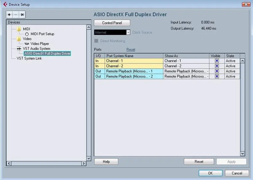

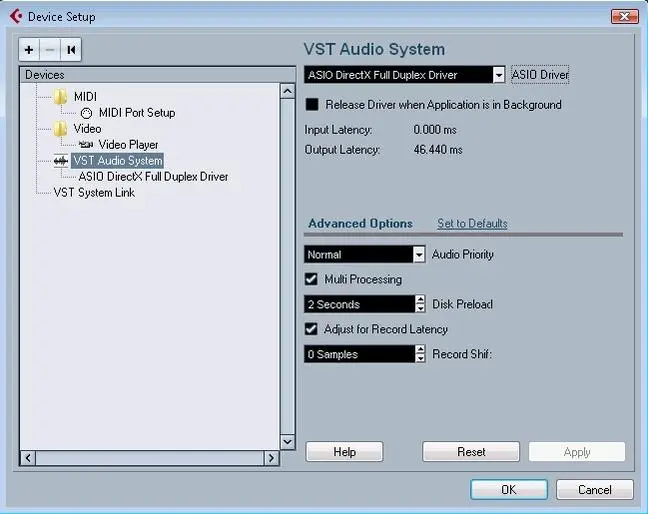

Hey everyone, I'm having trouble setting up Cubase le 4 to work. As the title suggests, it isn't detecting any inputs. I'm using an E-Mu 1616m connected to a Shure SM58.
Under "Device Setup" I've changed the VST Audios System to the E-MU ASIO, however it lists only two outputs and no inputs. Under "VST Connections" it doesn't display any input connections either.

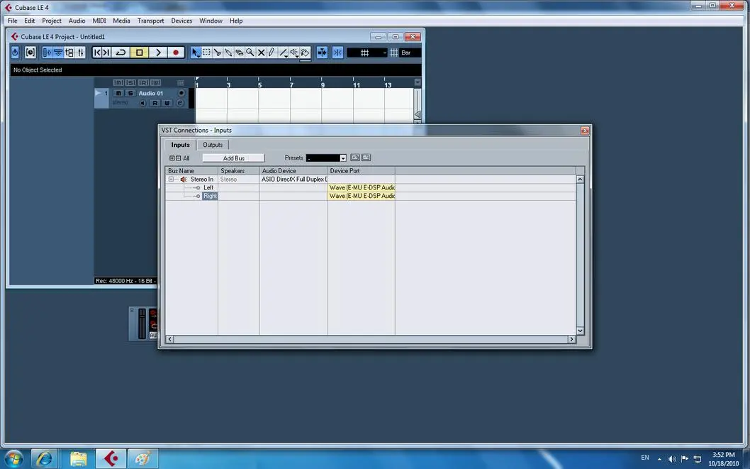

@Tetrafish Yeah, I've tried adding buses on the input column, but whenever I try to select the audio device it only says it's not connected. There is an option to choose the E-MU ASIO for the audio device on the input bus, but it wont allow me to pick it. I'm assuming because it doesnt detect any of the inputs.
So just to be clear you did select the ASIO driver in device setup?
and do the inputs show as visible?

You can see in the screen caps I posted they call it (where you select the driver) the "VST Audio System". There are also VST plugins that have effects, there are VST instruments etc..

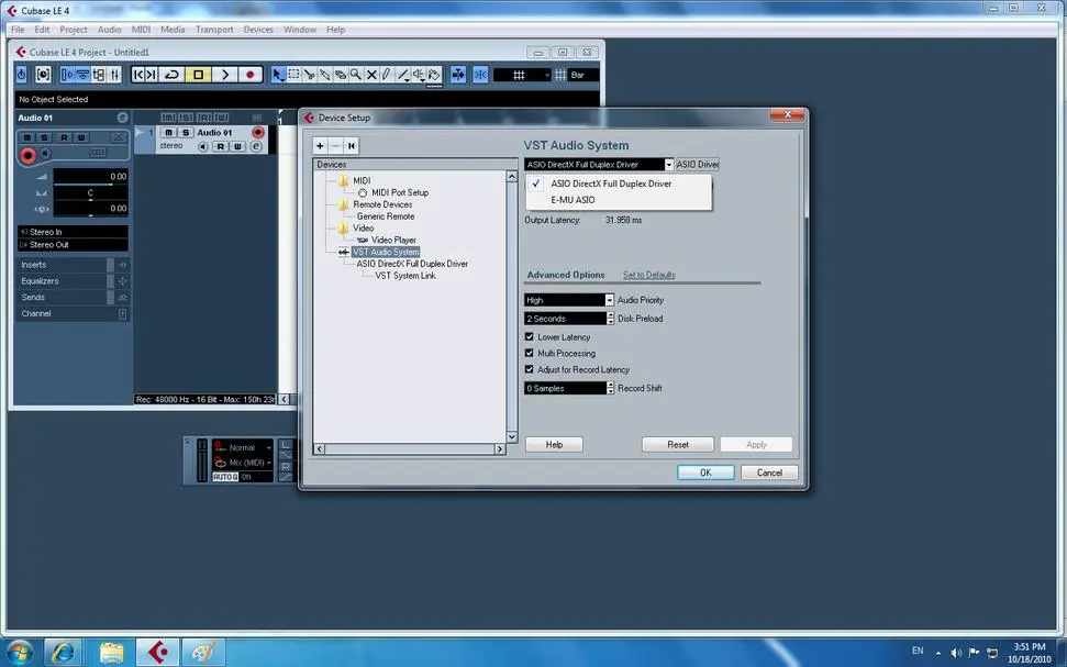

@Tetrafish Ok, making some head way here. I had selected the E-MU ASIO as the driver instead of the ASIO DirectX Full Duplex driver. (Pic 1)

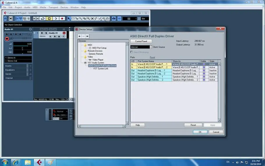

The inputs are showing now (pic 2), also showing inputs on the input bus (pic 3), but still not picking up the mic.

Select the proper input in the track and arm it for recording?
Haha, yeah it's armed, it just deactivates when you're messing with the settings like in the screen shots.
Oh, sorry I should have said, mine just shows the direct x ASIO driver, which isn't the one you should use. It should be the one you installed for your device. The latency will be crazy if you use the direct x one.
