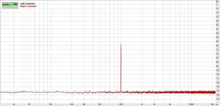

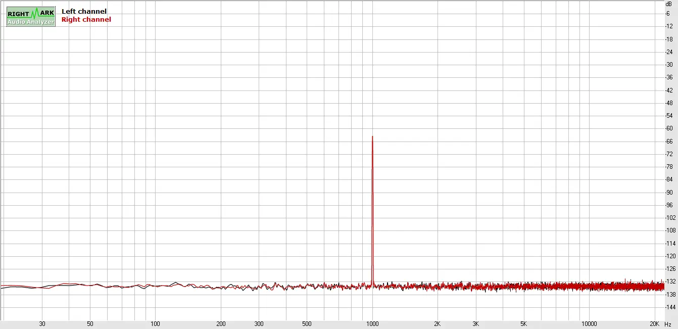

Done some quick tests with the Notepad FX8.
The spectrum is at gains set to '3o'clock' which gives about -20dBFS for lusty singing into a close SM57*. The recording starts off as 24bits but has to be converted to 16bits for Right Mark Analyser.
The 1kHz tone is internally generated in Samplitude and is for reference as RMA is not calibrated against Sam'.
You can see I think that this remarkably cheap mixer is virtually free from any of the spiky hash we see from the Gen1 16 bit horrors.
I shall try to do some more carefully specified tests on the mixer over the next few days so if anyone has something they want to know, shout!
