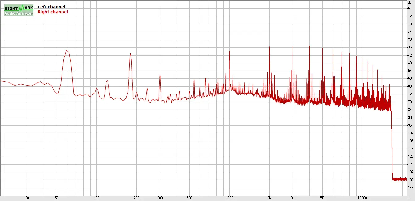

This is a short and dirty attempt to set things up, you might fail but come back and I will go through it more slowly and post some pikkies!
On the quality of the UCA 222? Yes, they are poor by todays standards but at 16bits they can get close to CD quality (about -85dBFS) For tape/vinyl dubbing they are fine. Recording the output of a synth should be fine as well, set max velocity to -6dBFS. I doubt many synth have a better than -80dB noise floor? I would not be AT ALL surprised to find that hum comes from the keys!
