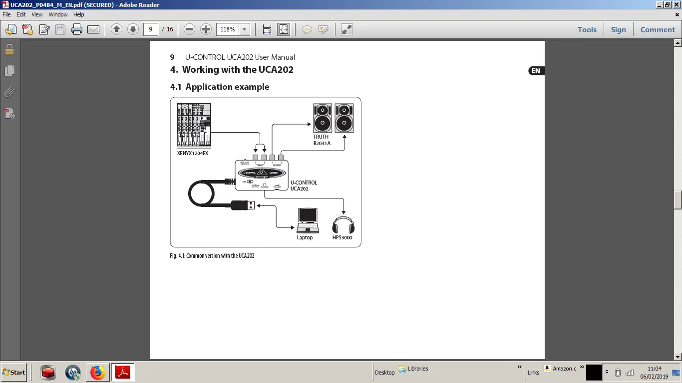

You can use it happily - but you are missing the vital part - the gizmo to convert the line output from the mixer into something the computer understands. Even if you could get the usb adaptor working, it is not designed for line level balanced input from a mixer and will probably distort like hell. A simple inteface would suffice as suggested above - going top cost between 50 and 100 or so, maybe a bit cheaper.
The confusion is that the xor to 3.5mm cable is not needed anywhere is it? You have a mixer with XLR outputs, and the USB adaptor has a female XLR for a mic (typically) - you would need and XLR to XLR to connect the mixer - what are you doing that needs a 3.5mm plug - the only usually available one is the mic input on a computer?
Attached is the idea using a Xenyx mixer. You would not run the monitors from the 202, there are better ways to do that but the <mixer to 202>USB port> is how it would be done.
The 202 is a 16 bit only device whereas almost any usual interface you buy will be the theoretically better 24 bits. However, for podcasting the improved noise performance of 24 bits would I am sure be totally wasted. CD is afterall just 16 bit!
