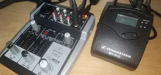

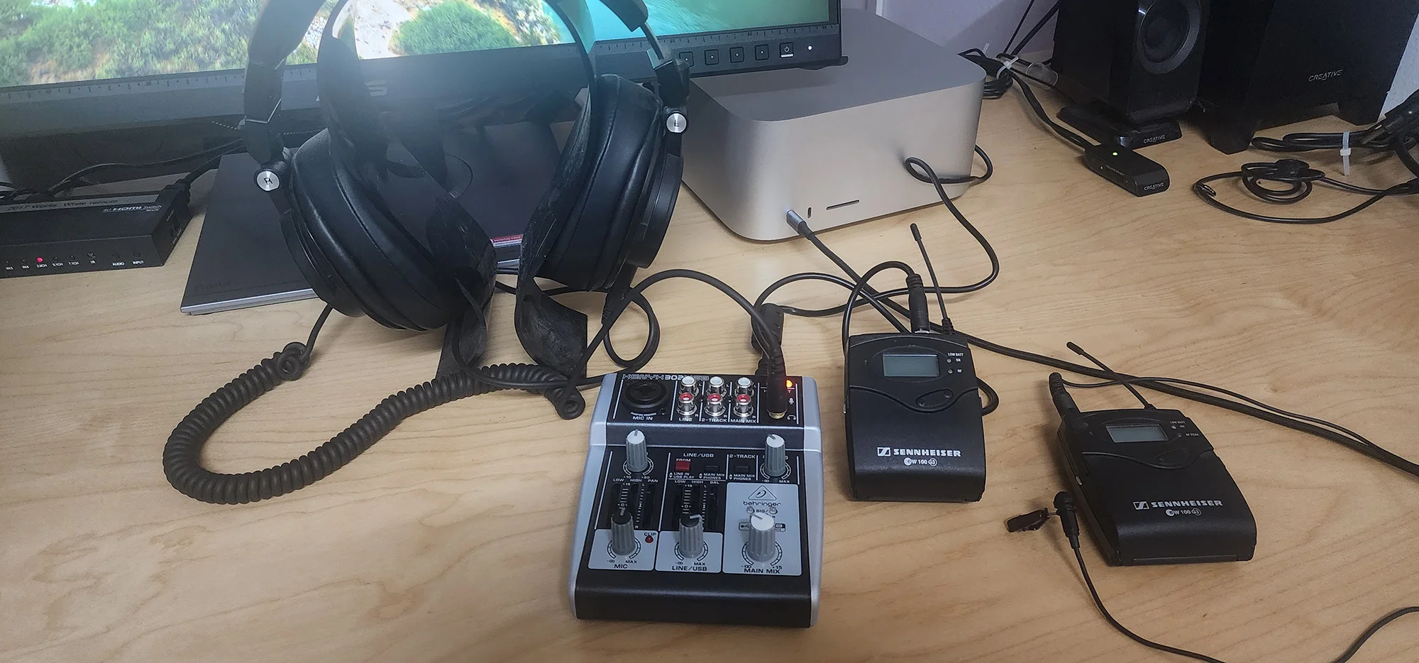

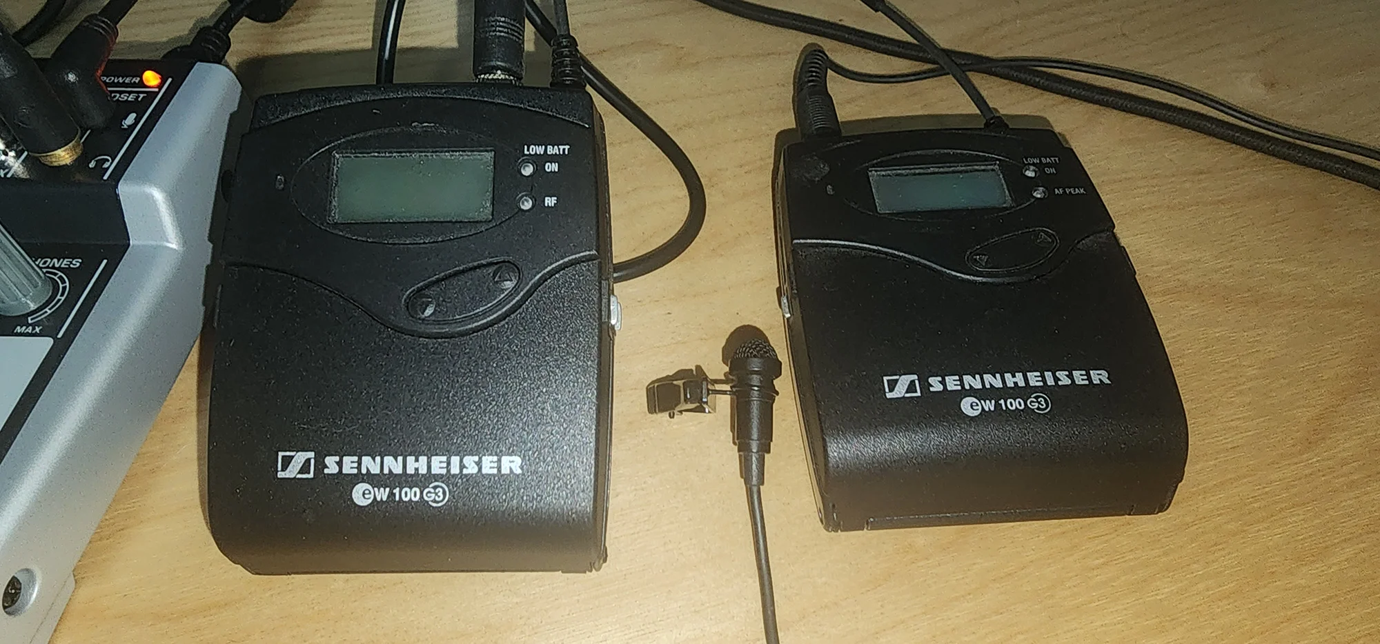

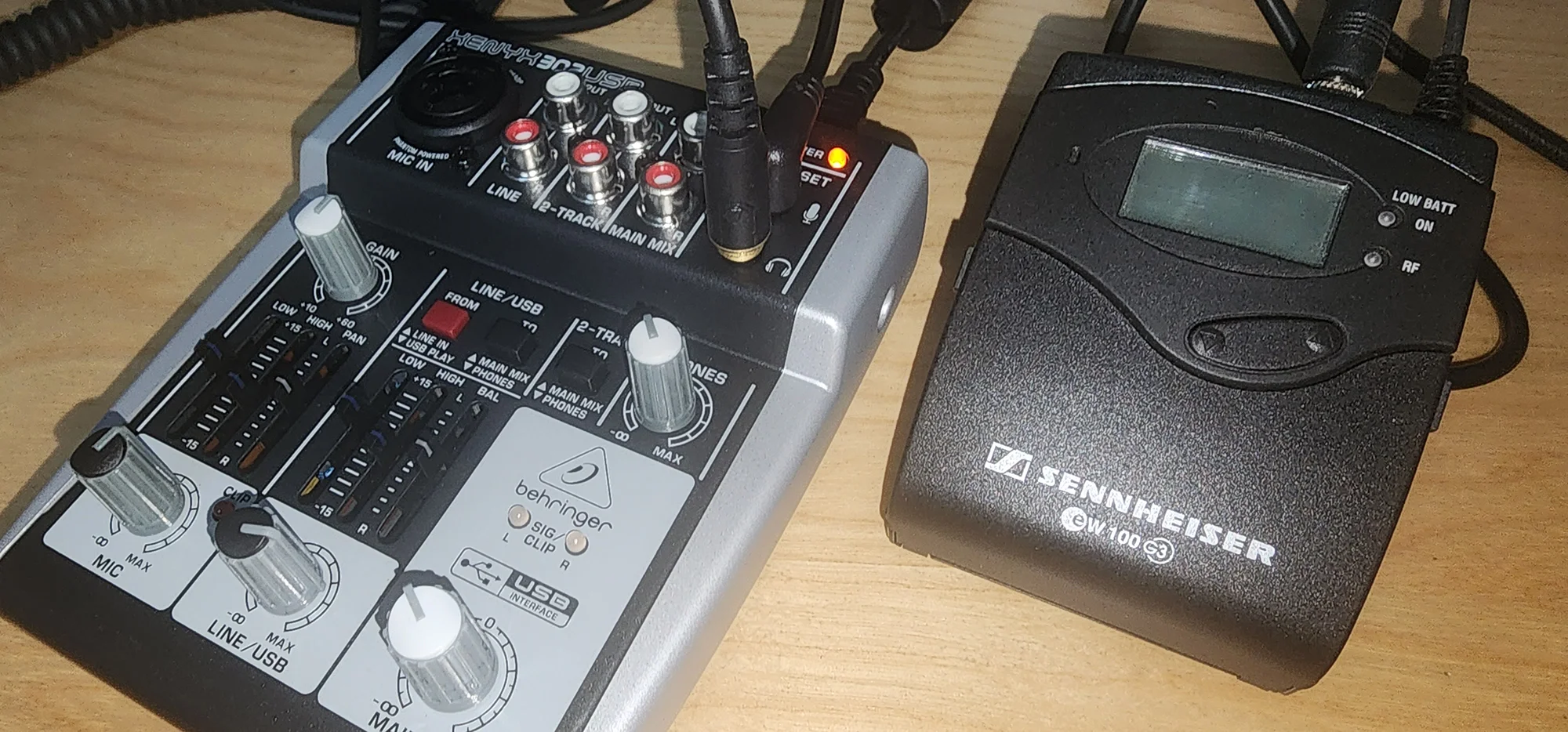

Here are a few photos that might help to explain my current setup. The wide angle shows all components involved. Then I include a closeup of the mic transmitter and receiver, and also of the behringer USB302 so you can see the 3.5mm jacks I'm connecting my headphones and mic to. The 3.5mm mic port is controlled by the two knobs all the way to the left. The mic is not an XLR mic, we originally purchased it to use connected to a DSLR recording interviews years back. It's been sitting in a cabinet unused for years so I thought I'd give it a shot with this interface.

You are going into the wrong socket on the mixer!
The portable receiver is designed to plug into the mic socket on the mixer. That version of the sennheisers, and i have a few of them, has very low output and usually runs with the 3.5mm output connected to an XLR connector. Normally video folk just plug them into their camera audio in instead of a wired mic. It will then be pretty decent snd noise free.

The Sennheiser cable is a short 3.5mm unbalanced at the receiver end, wired to a 3 Pin XLR, but with pins 1+3 linked for ground with signal on 2. I would not use an adaptor, but either make, or buy the correct cable - the adaptors on the receiver end put lots of stress on the socket. They're on ebay - search for Sennheiser XLR male to 3.5mm like this one UK ebay

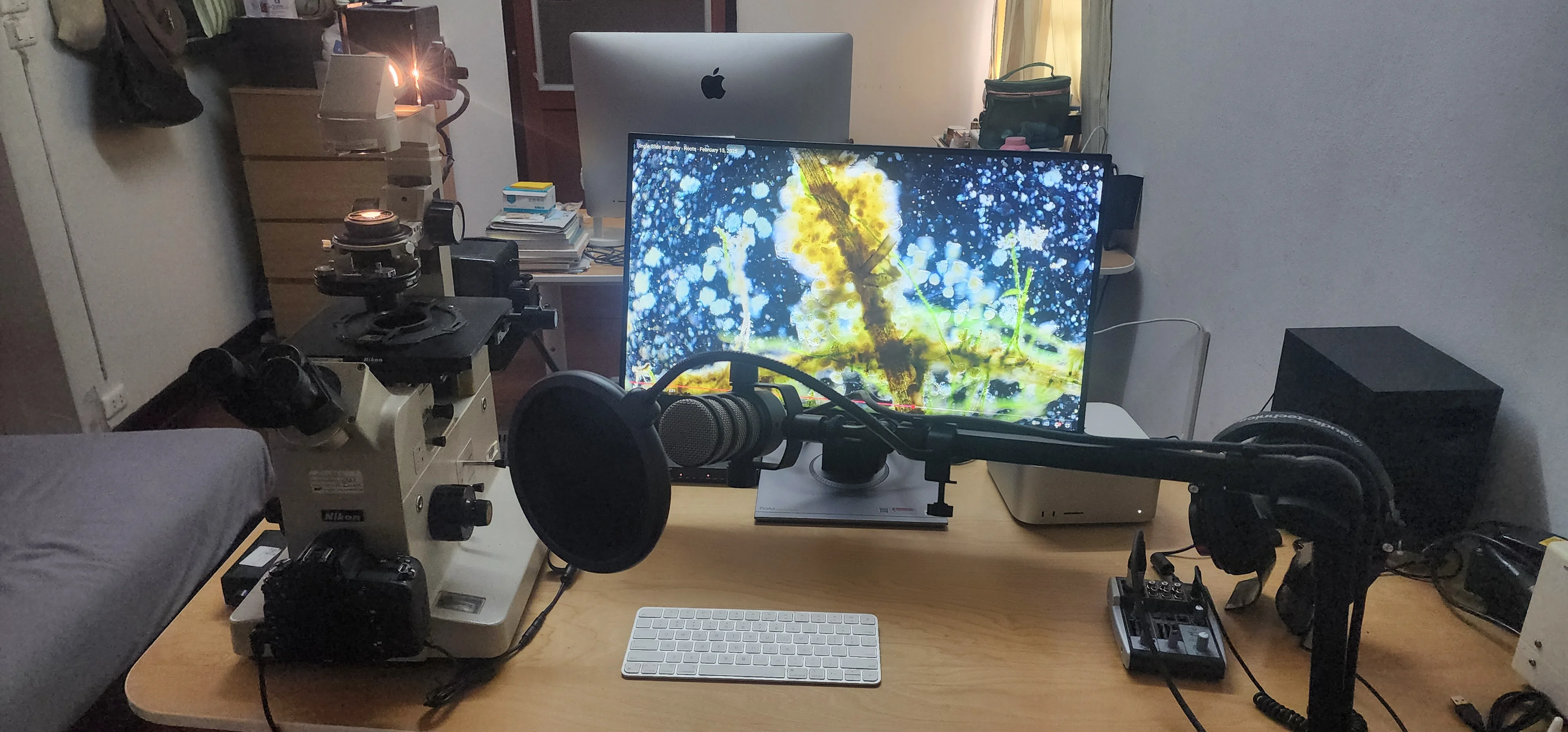

Here's how my setup has ended up. I think this will work well to learn the ropes for adding audio to my livestream views of the microscope.
