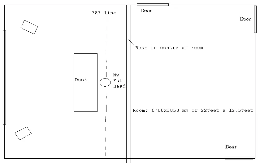

Please see my crappy diagrams below which will probably save me a lot of typing.
I have a few variables to weigh up and I don't know quite how to attack this problem. I am up to the part where I take into account :-
- what shape
- where
- and with what material to use
The *where* part is fairly self explanatory at this stage; corners of the room and reflection points, as suggested by John H. Brandt in this forum - thank you.
The material? 100mm (4 inch) 48kg/cm2 acoustic insulation, placed in the corners and bridging where the roof meets the wall. Also, three panels for the reflection points at the two sides and the roof. Where the panels sit flat against the wall, i could set them 100mm out fro the wall to get a better result.
Shape? Yeah, good question.
** So, in the hope of getting some answers here, I'll be specific: **
How big do the reflective wall (and roof) panels need to be? I can calculate the theoretical point of where on the wall the speakers sounds will reflect, but how much area of absorption should I attach this ?
Does the covering material (open 'burlap' type material to let air and sound through) go on all of these proposed panels shown in my crappy diagram? Or do I need different material on the bass traps to the "first reflections" absorbers?

I can make the first reflection absorber 1 foot x 1 foot. Or I can make it span the entire wall.
It depends on how far you are from the speakers. It's not a reflection "point" but rather an area. In most rooms, 4 by 4 feet of absorption will give you a very large "sweet spot."

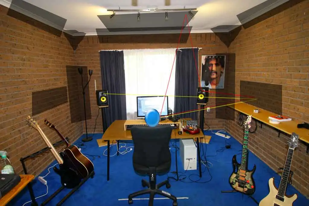

Can anyone comment on the shelf mounted on the brick wall on the right hand side (in the picture above). This shelf will be obscuring the 1200x1200mm first reflection absorber I plan to install. I can either split the absorber and mount it directly above and below the shelf, or I can remove the shelf. Do you think leaving the shelf where it is will defeat the purpose of putting an absorber there? How relevent is this?
Also, I just realized that my flat screen monitor is right in the middle of things. Is this working against the treating of my room?

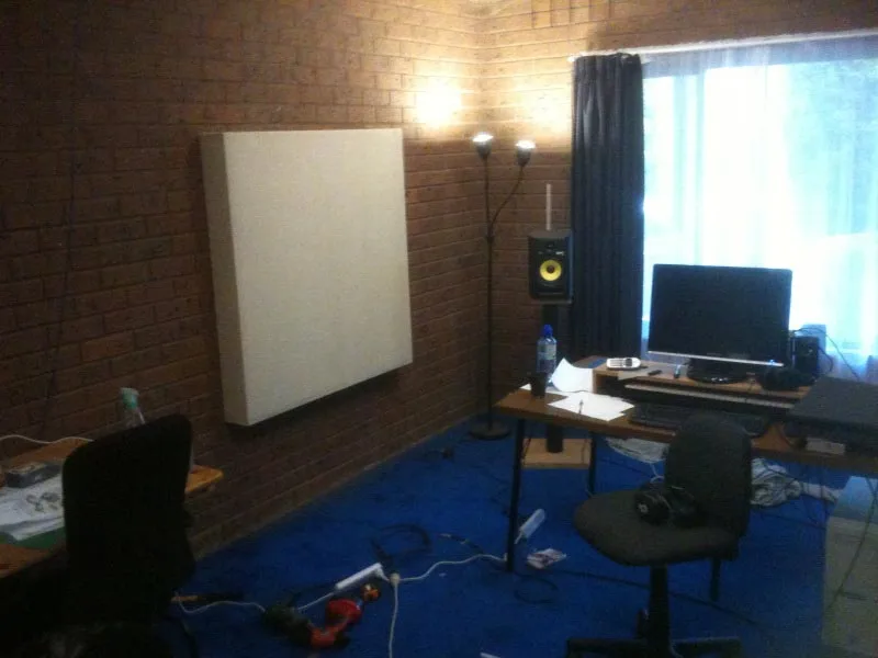

First panel up! First reflection point and bass trap.
Man, this was a mach larger job than first expected. but I'm up for it.
Found some Hessian (Burlap) material after consideration of many others. Yep, hessian works well in many ways.
.. and funnily enough, if you speak into the panel, there's not a whole bunch of sound come out. Can't wait 'till the others are up.
The help of a air compressor, staple gun and nail gun was *fantastic*. You want these tools if you're gonna built 15 bass traps.

75% there. Bass traps for the rest of the room to go...
FM

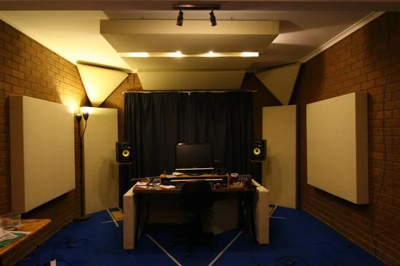

For those searching on bass trap building threads and how to mount them, I found the best way to mount those 45 degree traps (ceiling/wall) was to use masonary anchors with a hook or eye into the brick, then use chain to attach the traps.
*** make sure the anchors are in good and tight ***
The traps and the 1st reflection points have made a noticable difference already - stereo imaging. Also a change in the amount of bass I hear at the listening point.
I have no idea on the actual response of the room until I measure it, but going on basic principles for a rectangular room it was always *going* to need lots of bass trapping. So this will be a good start and I can treat further from here if necessary.
But really, all this is only to be able to mix down music that I've recorded. I really got sick of mixing something, only to find out that on most other hifi systems that the mix is all over the place. If the room is one step closer to having a linear response, maybe this issue will be sorted out for me. Plus, what's the point of having studio monitors when ther room is un-treated? Otherwise you as well use any speakers with any response, right?
Five more bass traps to go along the ceiling/wall joins.
... then on with the recording!
FM
