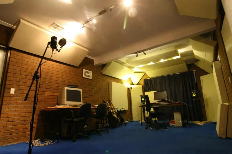

Well, finally finished the bass trap and first reflection project.
Damn, I was right for estimating the cost, but time (ie my labour) ended up being three times as much as I expected!
The important thing is - it works! I've mixed a few things, and them played them around the house, in the car, other peoples hifi's and the mix works. It is portable (I was having a huge problem with this prior to the build).
Also, I've been listening to music from my collection and it sounds just awesome.
At some stage I'll get around to discussing vocals recording, and the amount of reflection (diffusion) I need to get into the room. It sounds no where near as lively as it did. Maybe I can't use the one room for both mixing and tracking? Anyway, all fun and all ahead of me.
Thanks to all for your help.

ye man love th look im thinkin of doin th same thing with my room...
can u take a look at my layout n see if u reckon it will wrk?
i do plan on moving my desk and monitors back according to th 38% rule
wat are ur thoughts on this shape room?
Uploaded with ImageShack.us
Seems to be a pretty square room...which I've heard isn't ideal
i have a few packs nof the 75mm rockwool left over, i see u have used the 100mm will i be able to get away with the 75mm??? or will have 2 double it up?
