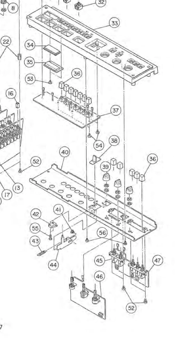

Yeah, Beagle I'm wracking my brain to remember how that comes apart...I don't recall it being that complicated...but it's been 7 years or so...
Gonna look at the exploded view in the service manual to see if that jogs my brain.

I remember now.
The face plate #33 attaches to the steel sub-panel #40 to which the the pots of the PHONE AMP PCB #46 are attached.
Remove the face plate and from there you should be able to remove the knobs and access the pot nuts.
Ok cool thanks. I did notice that steel sub panel when I pulled up the face plate. I'll try to get to that this weekend.
Ok, got the PCB out. Yeah the issue was that those three little knobs flair out at the bottom (which you can't see while the face plate is on). That's why they would seem to give but then wouldn't come off. They were slipping off the pot shafts, but then the knob itself wouldn't fit through the opening in the face plate. Once I got the face plate off, they came off like normal knobs.

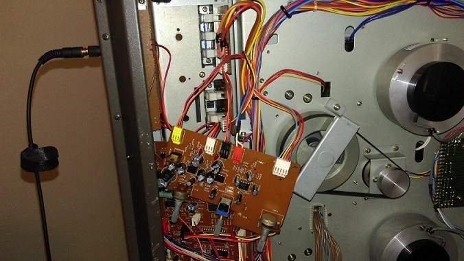

Well damn .. that was an exercise in frustration. I have the PCB loose with everything hooked back up (see pictures), but I'm still not able to get reliable measurements. I'm getting stuff all over the place.
I tried using the trace side, but I can't get a solid hold on anything because the PCB isn't mounted to anything. I'm always getting 3mv when I try that way. So I tried the component side. I can get a really solid contact to the chips that way, but I'm not positive that I'm making good contact with P101, pin 2. I can't tell whether my probe is reaching far enough into the plastic slot to make contact with the terminal or not.
FWIW, there were times where I seemed to be getting good strong signal (around 250 or 300 mV) at pin 3 of all the chips (U103, 102, and 101), but I couldn't recreate it.
I would try to measure from pin 1 to pin 2 of P101 from the component side and would only get about 120mV (whereas before, when it was mounted and I was using the trace side, I was getting 187 mV consistently). When I tried to measure those on the trace side, I couldn't get anything other than 3mV.
I tried clipping a flying lead onto the trace side of P101 pin2, but there's not enough lead poking through, and it keeps slipping off.

Nice pictures. Thanks for uploading those. They are helpful.
The PCB assembly looks really clean, so that's good.

I don't think I've ever changed the battery, so I went ahead and put a new one in there (it uses a 9v). Once I did, I measured the old battery, and it showed to be full, so I don't think that was it.
I've built a little shelf out of stacked cardboard boxes so I can lay the PCB on something solid when I try the measurements again. I imagine that the trace side will still be my best bet. It was just most likely that, since the PCB wasn't anchored anywhere, I wasn't able to get a good, precise connection with the probes.
