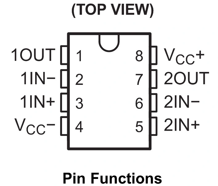

Can you get to pins 3 or 5 of U103?
I want you to do the same test as the last one, except compare voltage between P101 pins 1 & 2 to P101 pin 2 and U103 pin 3 -OR- U103 pin 5. I hope that makes sense.
We are checking voltage at P101 pins 1 & 2 to get our known voltage, and then comparing that to the voltage at the input of the monitor output buffer amp U103 (which we can measure by putting the - probe on P101 pin 2, the signal ground, and the + probe on U103 pin 3, the L channel input to the opamp, or pin 5, the R channel input to the opamp).
The last test we tested signal attenuation from the signal input of the board to the output. Now we are checking signal attenuation from the input of the board to a point just after the monitor level pot at the input of the output buffer amp. We are trying to determine where signal is becoming inappropriately attenuated.

Let me double check the schematic with the pinout on that 4558 opamp...
Okay. So the schematic is correct.
You should have signal at pins 3 and 5 of U103. You're positive you are probing pin 3 and pin 5?

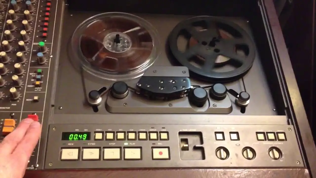

I tried pulling up the knobs (PITCH, VARI/FIXED/EXT, and PHONES), but I'm not having luck. They seem to come loose but then they get stuck, and I'm not able to pull them off the shaft as easily as I would think. I haven't really pushed it because I don't want to damage anything.
Do you know if there's a trick to getting that PCB free?

Oh ok, thanks. Yeah these are not the typical cylindrical knobs. They're trouble-makers. :) They're the bottom right ones in this picture.
You talking about the three knobs on the bottom far right?
I bet you'd have an easier time once you take the faceplate off. Looks to be just fastened with 4 allen screws.
For all we know there could be a flange at the bottom of the knob preventing it from coming all the way up. Who knows, im just guessing. But for sure. I'd take the plate off.
Those look like buggers!!! Pliers with duct tape around the jaws maybe?
RFR: I have taken the (transport) faceplate off. They come with it. In other words, the PCB to which those pots are attached is mounted to the bottom of that faceplate.
Bachelorb: I basically did that. It's strange ... they come loose, as if they're getting ready to just slide off the shaft (i.e., you can freely rotate them for the most part), but then they don't come off. It feels as though something else is stopping them. I haven't continued to yank really hard because I didn't want to damage them or something else.
I figured if anyone had taken them off, it would most likely be Cory (sweetbeats), so that's why I want to hear what he says (if he remembers).
