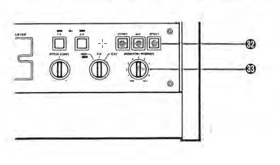

No it doesn't. That's the crux of the problem. The same knob that controls the headphone volume also controls the level coming out of the MONITOR OUT jacks on the back. In order to get a usable listening volume out of the MONITOR OUT jacks, I have to either have the headphones set at an unusably loud volume or crank my amp up to a dangerous level.
From the manual.
