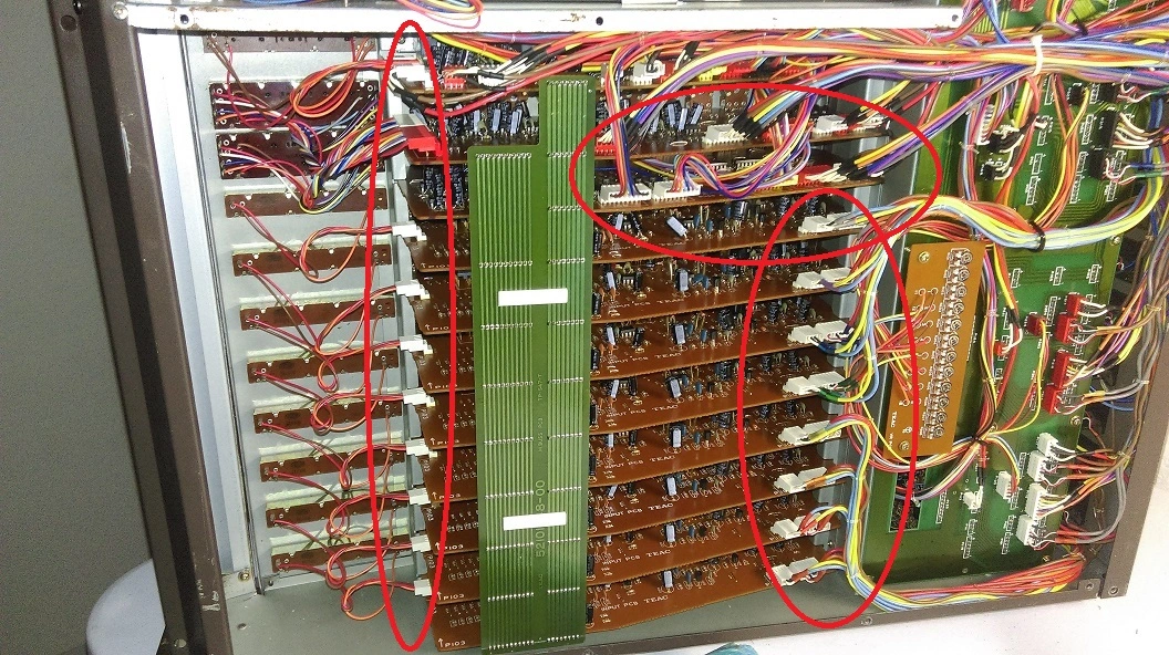

Your next request is maybe possible depending on what needs to stay connected and what can come loose. I definitely can't get to it as it is now (with the M BUSS PCB still connected and all the cards connected to the front panel).
I can unscrew all the nuts on the front panel and pull the cards out, but I don't know how far I'll be able to pull them out with all the connectors still plugged in. (See photo.)
Can any of these connectors be unplugged while taking those measurements?

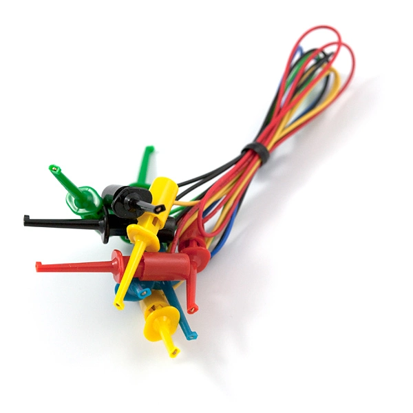

What would be ideal is if you could clip a small flying lead into the 'G' terminal of Q101 or Q102. Do you have any of those small captive clip wires (not alligator clips)? That would be perfect for this...you would remove the M BUSS PCB, and disconnect any connectors to gain access, then clip the lead on the 'G' leg of the transistor, then put everything back together and probe the other end of your flying lead and the terminal on the M BUSS PCB.
I'm talking about this kind of thing...They come in different sizes and you can get them pretty small, usually in a pack and they don't cost much:

Ok ... First off, no I don't have any of those captive clip wires, but I could get some. From looking at the picture, I can't tell how they work, but I imagine it would be a bit more obvious if I had them in my hand.
I've not see these befpre, but oscilloscope probes often work the same way. The conductor is usually a hook inside the plastic sheath. You pull the plastic flange back and the hook is exposed. You can then hook it onto the wire or IC pin you want, with the minimum amount of conductive surface exposed, so there's much, much less danger of a short.

Yes, you squeeze the spring-loaded plunger which exposes a small 'J' hook...you hook the component leg and when you release the plunger, and because of the hook, there's no risk of your clip touching other contacts even in crowded situations.
You *could* use hookup wire, but I wouldn't...I'd be worried about it coming loose and contacting something else.

Ok thanks. Whenever you get a chance, if you could direct me to a source to buy those clip wires you're referencing, I can get some. I'm not finding anything on my own.

Just ordered some.
Ok, I got those clip leads in the mail yesterday, so I can possibly take the measures on those JFETs this evening. I don't think you ever answered the above question, but if you did, I missed it. I'm just needing to know what all needs to stay connected when I take those measurements.

I did answer it but in a roundabout way...the coarse instructions I gave for what we will do with those clip leads guided you to put everything back together after having the clip lead in place. So...the ideal would be to disassemble whatever necessary to get a lead hooked to a 'G' leg of either Q101 or Q102, and then connect everything back up and conduct the test.
So here is what you will do when you can get to it:
1. Connect a flying lead to the 'G' leg of either Q101 or Q102
2. Ensure all L-R assign switches are in the up/unlatched position
3. Power on the 388 and, with the + probe of your multimeter connected to the flying lead, and the - probe touching pin 8 of connector P102 on the BUSS B PCB (A-OK to probe the related solder joint on the M BUSS PCB), measure for DC volts
