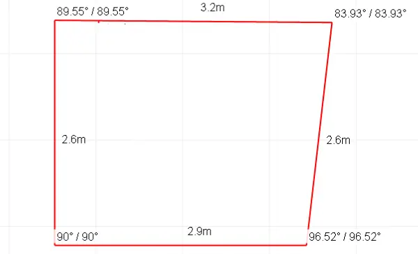

Hello you guys, thank you in advance for helping me.
I've attached a 2D version of my room, because unfortunately I'm not familiar with 3D drawing. my room is a little bit strange. as it's been shown in the picture, it's not rectangular. so first of all, what should I do about the angles below or above 90 degrees?
the height to my room is 280 cm. I checked the dimensions in amroc - the room mode calculator and I saw its not that appropriate! should we consider the dimensions before we do any acoustical treatments or after installing them? with my room being that small, is it wise to make something like a vocal booth or a quiet room within the room? I was thinking about my options: I can reduce the height by installing what we call a "fake ceiling" (I don't know the exact term) or I can make a room within the room with this dimensions: L: 200-250 cm/ W:150-165 cm/ H: 240-280 cm. what should I do? I just need a decent room to record vocals.
the walls of the room (about 8-10 cm wide) are made of bricks and cement, without any air gap in between. but if I'm making a room within the room, I would use drywall (not sure if prefabricated plaster walls we are using in Iran qualify as Drywall!) with the width of 10cm, then a 5cm layer of air gap and after that I'll be using Rock wool (80 kg/m3) with 5 cm width ( rock wool 2*1 m panel slabs with 5cm width). I'll be using acoustic panel as needed after I install the rock wool inside the wooden (1*1m or 2*1m) frames. am I using the right materials? would you be kind to help me figure out what should I do?

You've got two basic problems already - your room is almost a cube, and it's too small. You don't want to make it any smaller by making a 'room within a room'. I assume there's a door in one of those walls ... :D
What are you trying to record in there? If it is just vocals, you can try to make it as dead as possible because its too small to have good natural reverberation - similar to when people think they sound great singing in the bathroom because of all the tile surface reverb, but in a recording is sounds like sh*t.

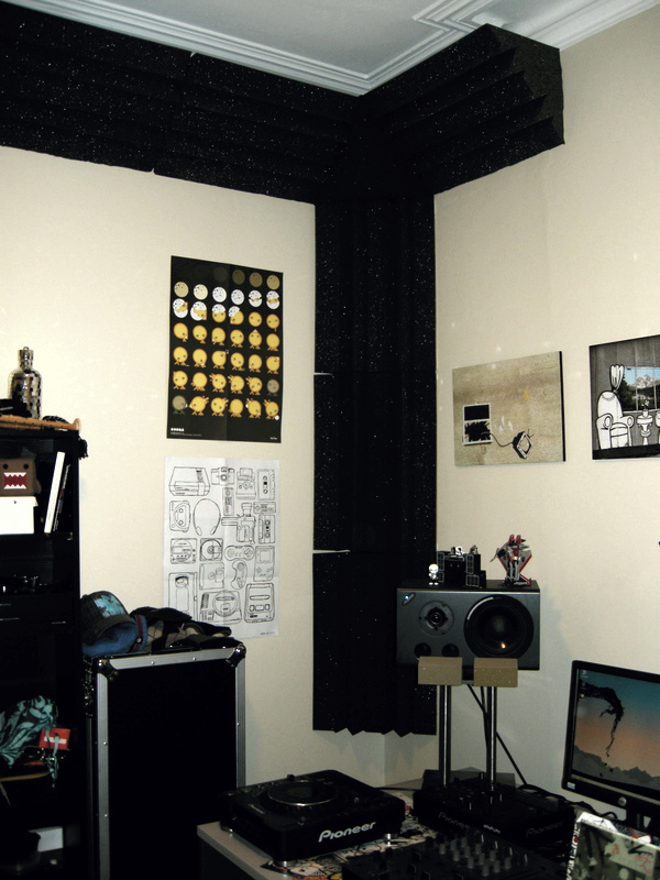

Bass traps should be at least 4" (10cm) thick and you're going to need a lot of them - all 4 wall-wall corners, and the ceiling-wall corners, and some 2" thick panels on the centers of the walls if there's room.

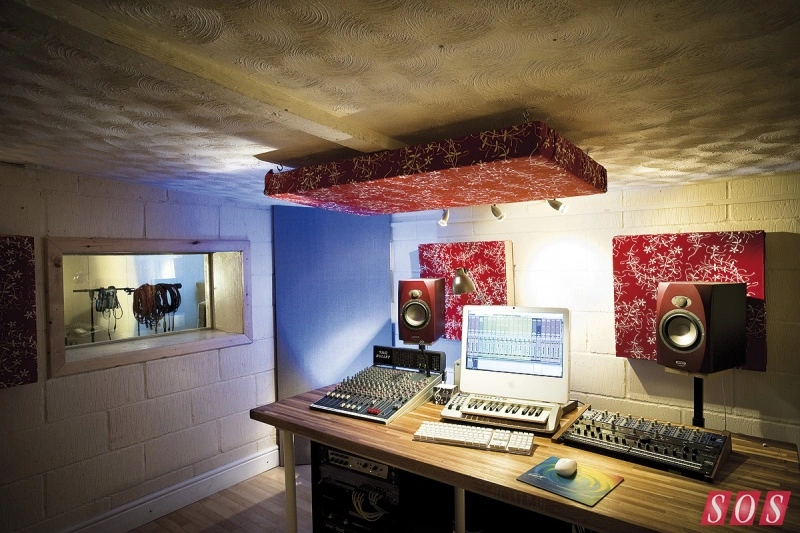

Hang a 'cloud' from the ceiling - minimum 2" thick rock wool.

There are threads here (and you can find youtubes) on how to build bass traps like the ones in the picture. Don't waste your money on foam - until it gets super thick, it doesn't absorb low frequencies. Start with corner traps (floor to ceiling), ceiling cloud, see how it sounds.

A 'cloud' is a trap hung above you (from the ceiling).

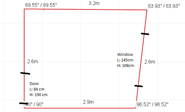

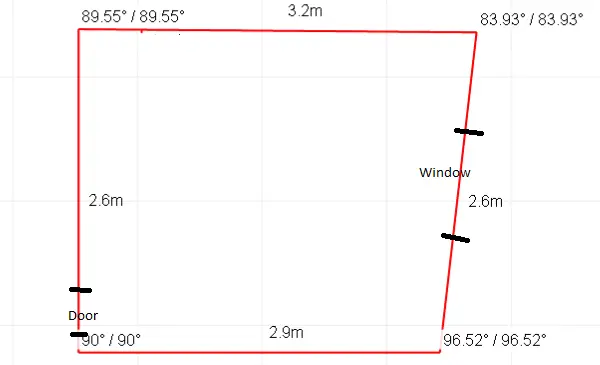

I know this placement is going to make trouble; I cannot block the door, thats for sure! but do you think it's a good idea to block the window? I mean is it necessary to do so at all?
besides, the extra photo attached which doesn't include the length and height of the window and the door is the photo I uploaded by mistake, but I couldn't get rid of it.

I don't think it matters, anything you do is going to be a compromise.
