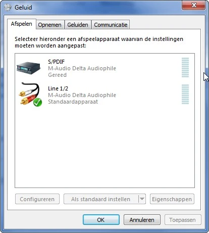

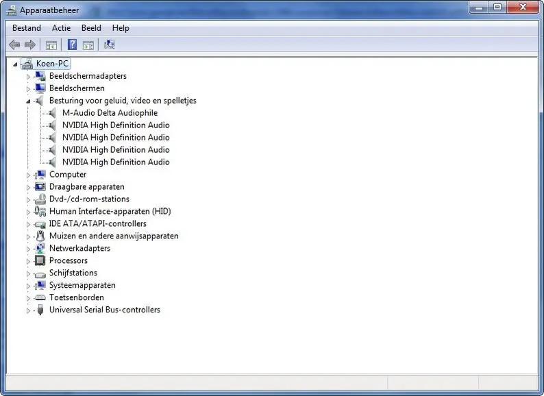

I've recently bought myself a new desktop with Windows 7 64bit. I installed my Audiophile 2496 and the latest driver (5.10.0.5074). Windows recognizes the card and there is sound.

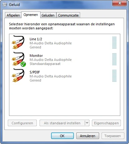

As a playing device I can only choose between S/PDIF and Line 1/2 so I selected Line 1/2. As a recording device I can pick either Line 1/2, Monitor and S/PDIF. When I select Line 1/2 I can record but there is a terrible latency. When I select Monitor there is no latency but the sound hangs (keeps repeating very fast).
I should also say that it worked ok yesterday (I had selected monitor as recording device), but because there was some minor stuttering on playback I decided to experiment with the settings (de-installed the soundcard and installed it again) and now I can't get it to work properly.

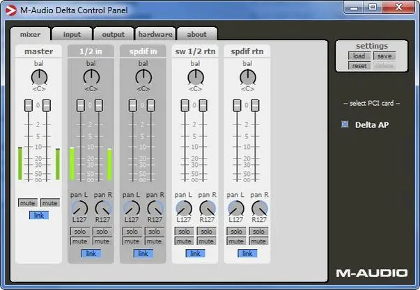

I've included a few screenshots that might shed some more light on things. Any help is much appreciated.

I had the same problem with the M-Audio card when the drivers first got released for it. The reason why you're getting the non-stop sound when you click the monitor is because the audio is in an endless feedback loop.
Both playback & recording defaults should set to Line 1/2.

I did/do have the latency issue also. The only real way to get around it is to:
1. uncheck "Listen to this device" in: Control Panel-> Sound-> Recording-> Right-Click on Line 1/2 on M-Audio Delta Audiophile-> Properties -> Listen-> Listen To This Device
2. Go to your DAW recording program and enable monitoring on one of the recording channels.

Unchecking "Listen to this device" did the trick. Latency is gone now. Thank you.
