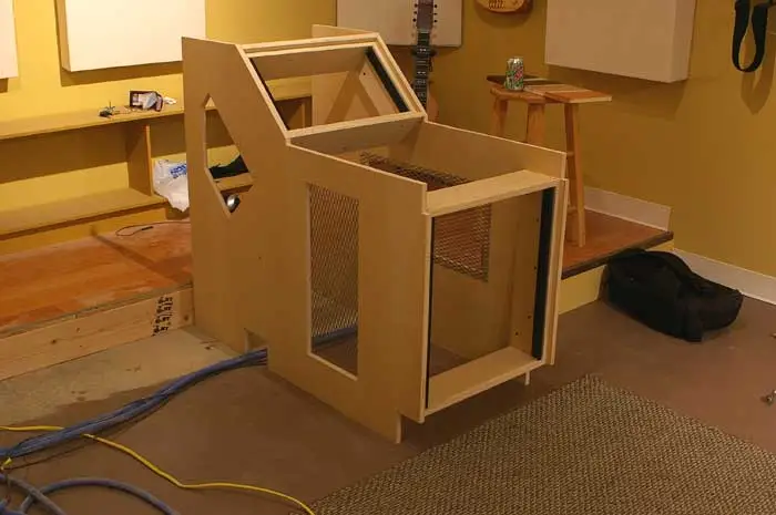

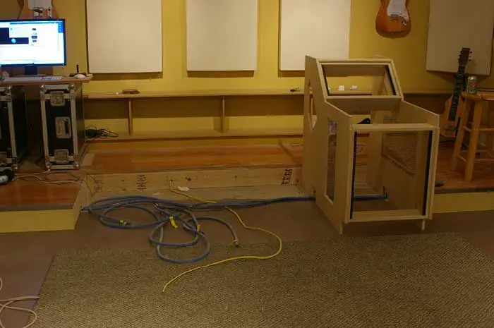

...and you get this: one modular chunk, the right side. You'll see venting, both on the outside and insides sides. The funky shaped hole on the inside piece is a wire pass-through for connecting all the rack gear--it won't be visible when complete. Oh yeah, I also added the rack rails. Here's that piece in place:

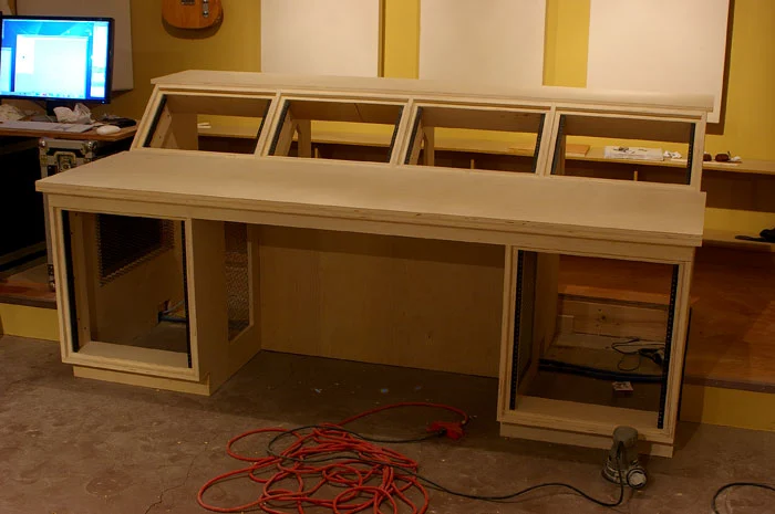

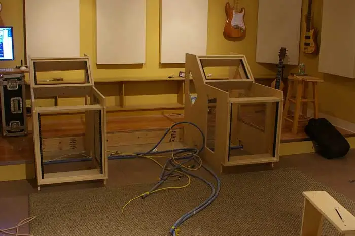

Here's the rest of tonight's progress: both modular side pieces in place (first pic), then one of the middle sections in place (second pic), then, finally, both middle sections in place (third pic) showing the whole structure of the desk.
Next up: anchor it to that elevated floor it's built into (so it's absolutely rock solid), then cut and install all the horizontal pieces--cross braces, desktop, top shelf, modesty panel in the seating opening, and a small finish rail across the top of the front.

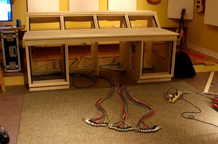

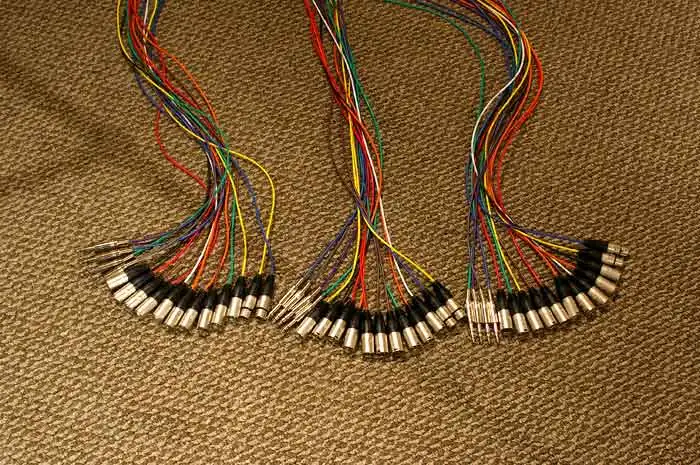

So the desk construction came to a screeching halt. I was having such fun with the carpentry and assembly that I almost put it all together--and if I had, I'd have screwed myself!
I had 3 16-channel snakes coming up under the desk (from the 3 wall panels mentioned earlier in the thread) and they all needed their ends soldered (XLR male, XLR female, and TRS). If I'd finished the desk, I'd have had to do all that soldering from a very cramped space behind the desk.
So I paused the desk construction for a couple/few days to finish the snakes. Now I can tuck them back under the desk and finish building it.
The pic with the desk only has the horizontal pieces sitting in place--they're not attached yet. There'll also be a panel closing off the face of the area where my legs go when I'm sitting--that's the piece that would have blocked access to these wires. I'll finish (assembling--not staining and topcoating) the desk in the next couple days.
See you then! :D

I know the desk looked done in some earlier pics--but it wasn't. Some pieces were just sitting in place. So this pic isn't a major development, but the desk is now completely done. Finished putting it together, filled all the seams & gaps (:eek:) with stainable putty, then sanded it all to 150 so it's ready to be stained. If I feel like staying up late, I may do that tonight. That would at least get me to topcoating this weekend!
