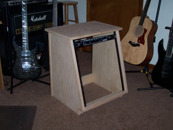

Hey guys, I just thought I would share some pics of my new rack that I slapped together this weekend. Just using about 35.00 worth of oak plywood and oak corner trim and a few hours on saturday afternoon.
I haven't applied any finish yet but that should be done tonight.
Won't catch me spending 2 or 3 hundred bucks on a freakin' rack! :D

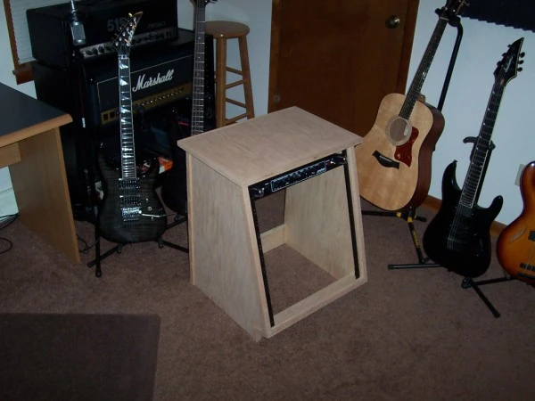

one more pic....

Looks good dude. Nice piece of wood, also. Did you have to search through a huge stack to get it, or did they have a bunch? Sometimes finding a good sheet is pretty hard.
Oh definitely, out of about 50 sheets at the Home Depot, I think there were only 2 or 3 decent ones. It's always like that ain't it? Thanks, dude. ;)

Where did you get metal attachment strips in the front? Did you find something commercially available or did you form it yourself somehow.

I actually scavenged those from a crappy little metal rack that I had. But you can buy rack rails all over the internet. I know you can get them from musician's friend

The rack rails are "MAP" (Middle Atlantic Products) brand, available from sam ash, sweetwater, zzounds, or even ebay. Cheap too!
Another option is to buy a "relay rack" that is 6-7' in height, and hack off sections. Much less costly that way, but significantly more work obviously. I prefer aluminum relay racks because you can cut them easily with a table saw - the aluminum used in relay racks is softer than most hardwoods like oak, so you can feed it slowly and make a really nice, straight cut.
Relay racks are also "U" channel typically drilled and tapped on both sides, so if you rip the rails lengthwise, you'll double your supply of rack rails very easily, at no cost. Seven feet of relay rack suddenly becomes 14 feet, meaning instead of 48U of rack space, you now have 96U.
few questions. How many spaces is this rack? I was about to pick up a raxxess RES 18 slanted 18U with casters. I REALLY like the look of yours. and if you are interested in building more, let me know. I dont have access to any woodworking tools. PM me if ud wanna sell one.
Matt
Mine is a 12 space rack. I built mine with specific size constraints in mind rather than a certain number of rack spaces. You could build a slightly upscaled version for 18 spaces and it wouldn't look too much different.
If you are serious about having me build one for you I could. I could surely work something out that could be broken down into panels to make it shippable. Let me know if you'd like to work something out.
