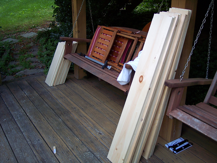

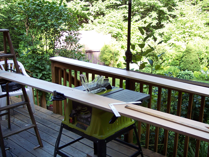

I started with 12' planks...8" x 3/4"...and then cut the individual pieces from them on my table saw . The 12' long planks were a bit awkward to work with until I made the first cut...but I managed to not fuck up any of the cuts.
From each 12' plank I first cut out the two long and two short sides for the traps. I had zero room for any errors since every square inch of the wood was going to be used for something.

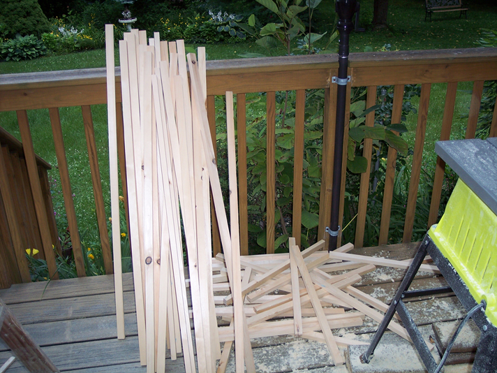

Then from the cut pieces I ripped the moulding strips that would be on the finished traps.
I used 7 planks total...the 7th one was needed for the additional moulding strips, since I could only get one side worth of mouldings out of the cut pieces that I used for the sides and tops. Some basic math - 8" wide planks, (actual 7.25")...6" width needed for the sides/tops, which left about 1" for the moulding strips on one side of the trap, and the 7th plank gave me the mouldings for the other side of the traps....and of course, I had to account for what the table saw ate up.

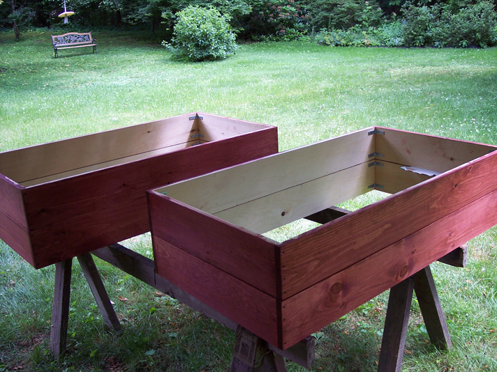

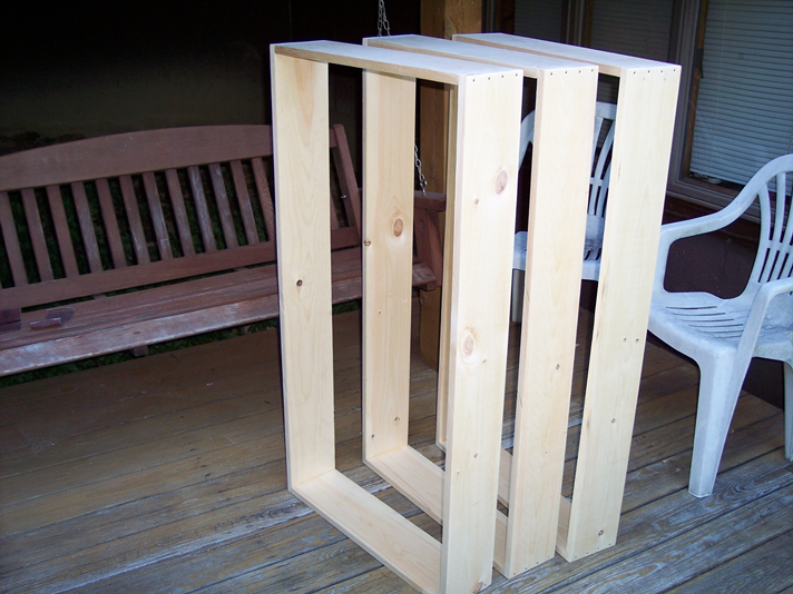

I then assembled the basic sides/tops of the traps, using wood glue and screws on the outside, and I also added some 3" L-brackets on the inside to stiffen things up.

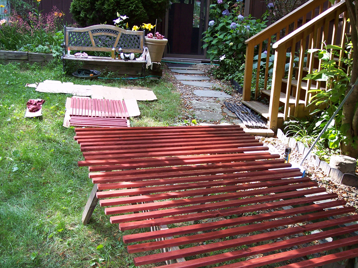

Then I did some light sanding, and staining, and I also gave them a light coat of satin finish polyurethane just to add a dull sheen to them, which I then buffed out with a scrubbie pad, as I didn't want a real shiny finished look.
I then repeated the whole process with the moulding strips. These actually took longer, due to the sanding, since the edges needed to be rounded off a bit on the each moulding strip for a nice look and feel.

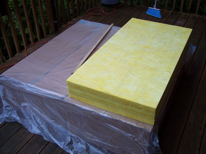

Then I turned my attention to the 703 insulation.

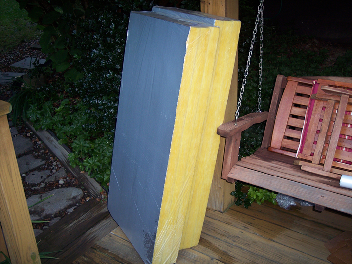

I didn't want any fiberglass particles to ever be freed from the traps, so I wrapped each 3-layer 703 sandwich with a real thin, 0.4 mil plastic (basic painter's drop cloth), and taped up the seams, and I also reinforced the side corners with some extra tape, so the light plastic wouldn't rip on those L-brackets when I stuff the insulation into the frames.
This is how the 703 sandwich looked after wrapping. The very thin plastic seal will have basically zero effect on the bass trapping...while providing 100% sealing of the fiberglass. I just didn't want any fiberglass irritation in the studio, considering that the traps would be moved around a lot....and it certainly isn't something you want to be breathing in if you don't have to. Cloth alone might be OK for a mounted wall trap...though I would seal them too...as the fiberglass particles are small enough to push out through the porous cloth.

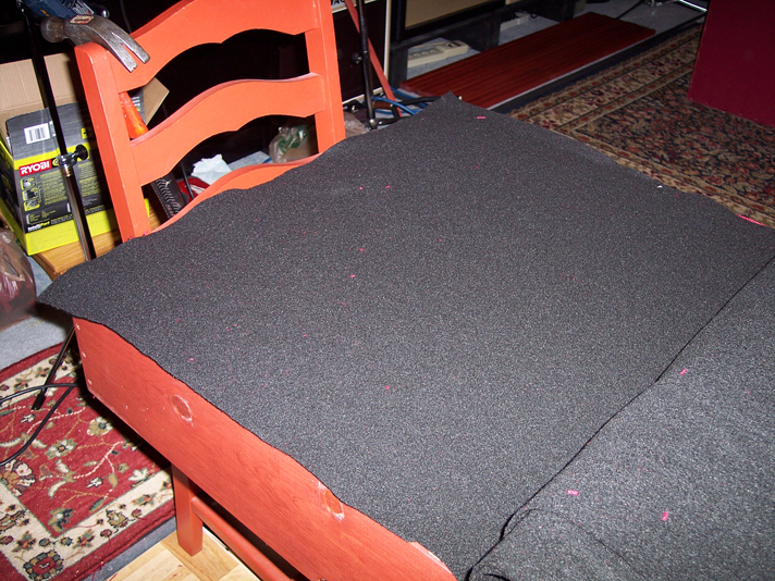

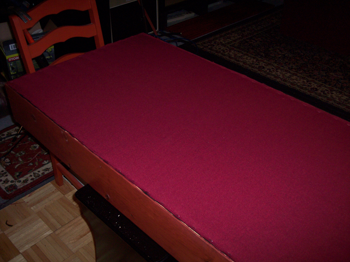

Once the 703 was sealed, I was able to take the rest of my trap building inside, and I ended up finishing them off right in the studio....starting with a layer of polyester felt.

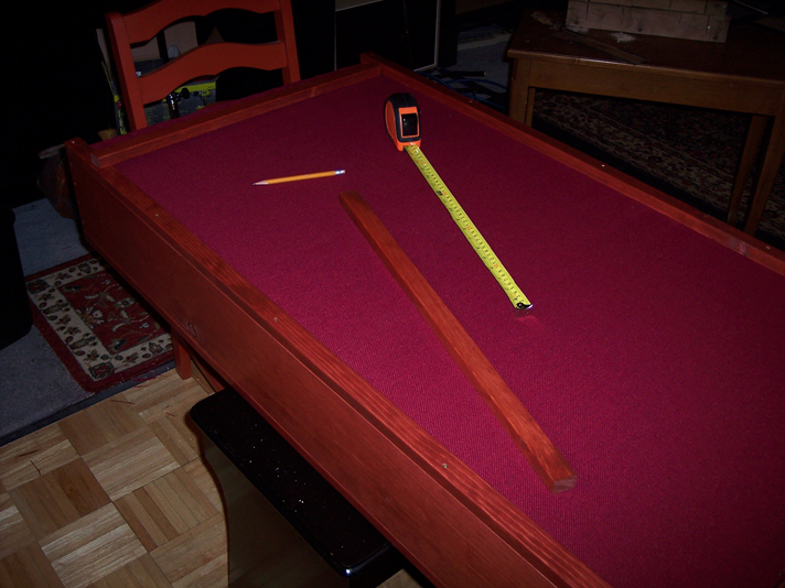

I was going to just use the Guilford of Maine FR701 fabric at first, but decided that I didn't want to see the 703 foil or the yellow fiberglass peeking through the GOM fabric pores...so the black felt took care of that, and also provided a light "cushion" to the 703 FRK side, so that there wouldn't be too hard a reflection of mids/highs, but I would still get the effect of the FRK membrane on the lows.

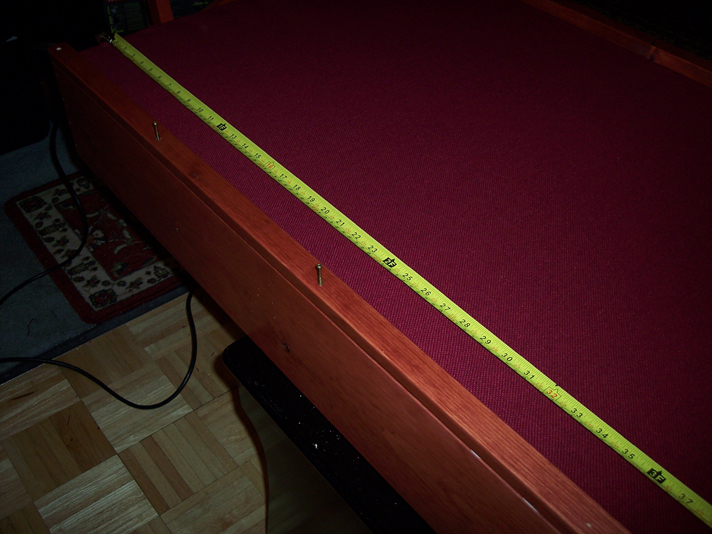

After the polyester felt came the Guilford of Maine FR701 fabric, which I wanted for both the fabric quality and the final look. Yeah, it cost more, but like I said, I wanted really nice looking traps, and not something that would look like stuffed sofa cushions. Both the poly felt and the GOM fabric were each stapled to the edge if the frame...same process on both sides of each trap.

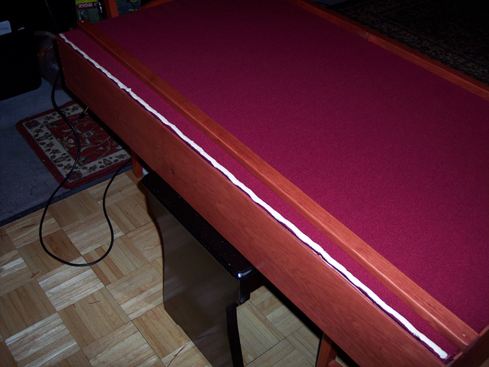

I then stared on the moulding strips that would cover the stapled edges and give the traps their finished look. I made sure to put down a nice bead of wood glue, both for the moulding strips and also to seal the seams of the GOM fabric so the threads would not ever come unraveled on the cut fabric.
I then screwed down the side mouldings using the same type of screws that I used to assemble the sides of the traps. They are GRK Star Drive Trim-Head Finish/Trim screws that can sink in like a finishing nail, but have the better grip of a screw, and they look really nice with the brass color on these traps. Since I was also using the wood glue, I didn't need to go nuts with a lot of screws per moulding.
Same thing on the top/bottom mouldings...same thing on both sides of each trap.

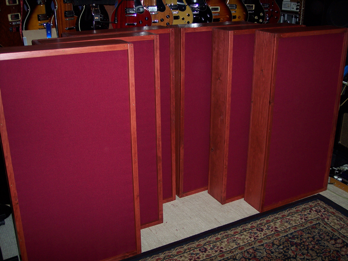

These are the 6 finished traps, and TBH, I was quite impressed with how well they came out, and the fact that I didn't have any major fuck-up from start to finish...and everything came together the way I had envisioned it in my mind and how the math/measurements were computed. Nothing wasted.
These are certainly not for everyone, and they took some time, and they are not the cheapest way to go if you just want to do quick, basic wrapped-around traps for the walls...but I did some shopping around for ready-made traps, and this size of trap, with this thickness, using 703 and 703 FRK, not to mention the finished wood look...would have cost me 2-3 times more ready-made...but I also didn't even see anyone that had anything that looked like these.
Most everyone sells the same old wrapped-around stuff, that has no back side, as it's meant to be mounted against a wall or corner.
So in the end...I'm quite happy with the results, and glad I went the DIY route.
