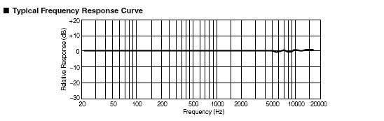

The Frequency Responce Chart of the Panasonic Capsules he uses is allmost Totally Flat through the Whole Frequency Range....
Here is a Pic of the Frequency responce chart:
